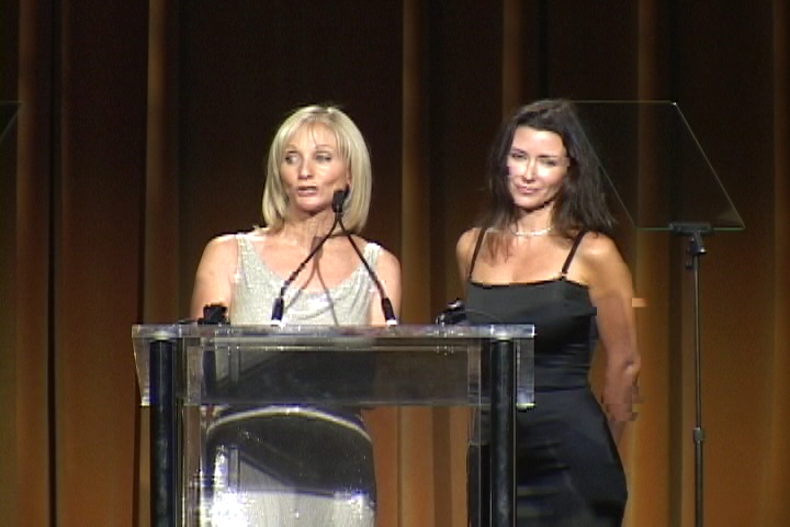

here is an example of a video i am trying to encode from a Mini-dv tape over firewire.
whats causing the pixilations?
what can i do to get a better quality encode??
system: Dell 3.20ghz processor w/ 4gb. RAM

Could also be your project settings or the tape. Did you record this footage with a camcorder or did you copy it from somewhere else to the Mini DV tape?
Please advise your capture settings and project settings of the editing project in VS 9

Looks like digital pixelation, have you watched this on your tv, does it show up there when played via the minidv player. If it shows there it is in the recording and there is nothing you can do about it, except try a head cleaning tape to see if it is dirty heads causing poor playback and not dirty heads caused poor recording.

Looking at your sample picture it appears your bit rate is too low, though until you follow the above guidelines we are unable to assist.
