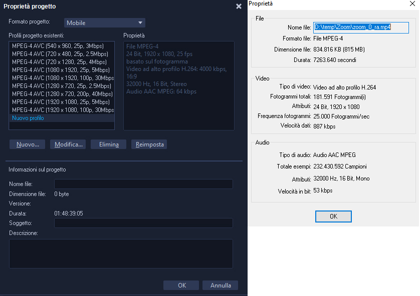

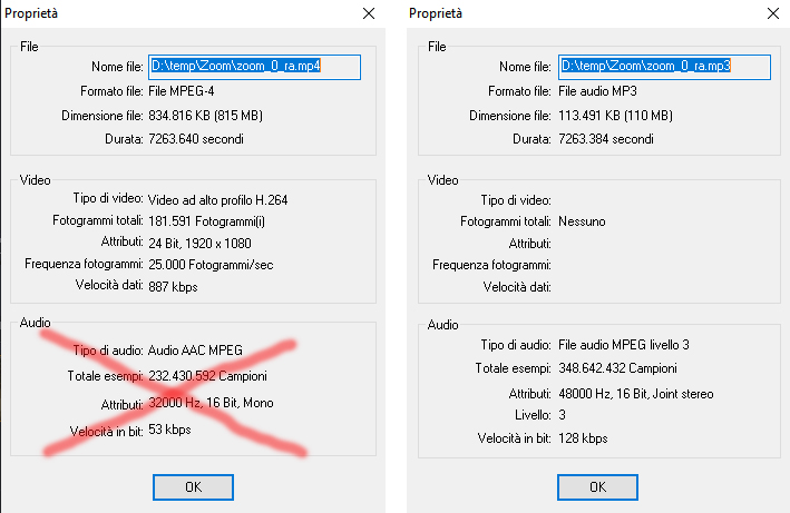

I notice that the audio file is approximately one third of a second shorter than the video, and I am wondering if that is the sort of asynchronicity that you are hearing? I am also wondering if it is deliberate -- with, for example, the audio starting at exactly the same point as the video but ending slightly before the end of the video? Or whether the lack of sync happens progressively throughout the video?
Video Studio also has occasional problems with mp3 audio, especially if it has been produced with the LAME codec. One thing you might want to try would be to convert your audio file to standard .wav format. A number of us here use the freeware Audacity program for that. Once converted and inserted in your project, you could render again to see if this has improved the sync.
Completely unrelated to the question of sync, I also noticed that the bitrate of the video is extremely low (887 kbps). For a high definition video, I would have thought that this would give you a very low quality final video. Or again, was this deliberate for some reason e.g. to fit your 121 minute video below a certain overall size for posting, say, on You Tube?

Hello Ken,
thank you for reply.
the video properties you see are from one of the many clips that make up the final project. All the clips come from the same source, so the properties are the same (not the length). The project was mounted inside the multi-camera editor and only one of the many clips provides audio for the whole project. When I move multicam project to Edit workspace, the project already appears with a slight out of sync. After rendering the out of sync increases. The lack of synchronization occurs progressively during the video and at the end the audio anticipates the video by several seconds.
I just tried converting audio to wav, but with no appreciable results.

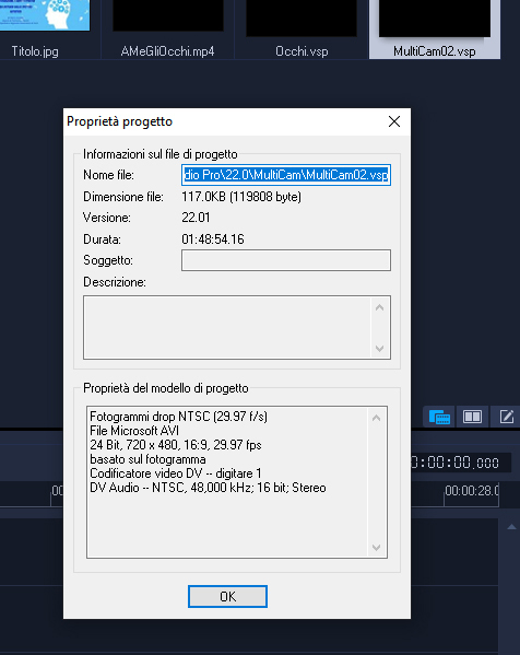

Hi
Just trying to think why the MCE.vsp is ok yet on the timelines is OOS
What are the properties of the main project as you see from Settings - Project Settings compared to the video files used on the timelines, are they using the same settings and frame rate?

Hello Trevor,
in following image there are Project Property (where is a white layout?) and Video Property:
I think VS should, regardless of the video and audio input formats, convert everything to its own format, allow it to perform all the necessary editing, and at the end reconvert its own format to any required video format. It does not seem professional for me that the user should be careful to avoid speed, resolution or other conflicts. it shouldn't be difficult to do, why nobody thought about it?

When I've experienced an audio sync problem, it was because of a mismatch between the Project Properties and the properties of the source clips.Airone wrote:Big audio sync problem

Hi
Can you check the final render properties, what are you choosing when doing Share
There is the option to Render using Same as Project properties or Same as First Clip, did you use one of those options?
Take note of the Audio – Attributes 32000HZ 16 bit Mono
If you use one of the default templates it may use 48000 Hz, 16 Bit, Stereo, it could be the change in HZ that could cause the audio shift?

After countless tests I was unable to solve the problem. I really tried everything, but without any appreciable result. But...
I don't know why, but by right clicking on the multicam project and selecting "Properties" I saw this:
Where do these wrong properties come from? I don't know where they were set, in the MCE I have not found properties to set. Is it possible that the problem depends on them?

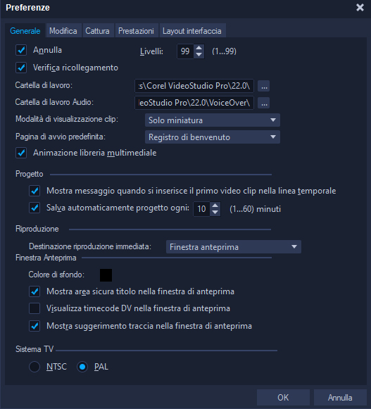

Hi
As far as I knew, at least what I have always thought was that the frame rate used by MCE would use the frame rate of Camera 1, now I have just run a few tests and that no longer holds true, my frame rate seems to use 25fps irrespective of the video being used
I then changed my project properties, it does appear that MCE uses the project properties frame rate, the frame rate is the only important attribute, the VSP being AVI is just a container a wrapper.
When we drag and drop the vsp to the timeline we only drop the content the video clips to the timeline. So the VSP.avi is not used as such.
OK
Using MCE, this my approach
1 / I start a new project
2 / Create a new library page and insert my video files
3 / I then drag one video to the timelines to activate Show Messages to match the Project Properties
4 / Clear the timelines
5 / Select the clips in the library ( shift + Click) , with a right click for MCE, that opens the MCE Source Manager with the clips selected, ok to open MCE
6 / The resultant VSP does use the Project Properties and as such the timelines frame rate.
What I do not understand is why you see 29.97 fps as that indicates the Project Properties are using 29.97fps.
Go to Preferences F6, at the bottom of the panel shows the TV System, that should show Pal, if it shows NTSC then the program may have been installed to NTSC, which is the default option when installing.
OK

It is very strange, in the preferences the TV system is correct: PAL.
Where does NTSC come from?
