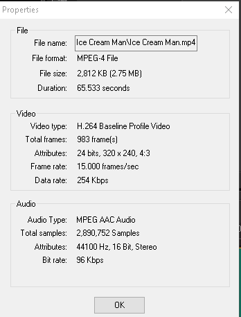

Can you please right click on the clip in the video editing timeline ("timeline" for short) and select Properties. Then either copy all the details on that page here or else take a screen shot of the Properties box and upload it here as an Attachment. That way we will at least have an idea of what exactly we are dealing with.

Hopefully that is what you are looking for. I did right-click on the file that has the problem.
It's interesting that the problem is only for 10-15 seconds out of the 2 min. video. Note that the properties I copied are from the file after editing/cutting some out. But I have the same problem if I do no editing at all to it.

Hi
That video is very small using a frame size of 320 x 240.
Because of that playback will be poor showing pixelization What did you use to download that file, I would have expected at least 1280 x 720 for video downloaded from YT?

Yes, it is small. Between it originally being an 8mm movie, 2006 when I did it, less technology, etc. As well, back then most folks that would be watching it had dial up...so the goal then to be able to play it over dial up. So it is what it is. I'm not sure I even have the movie to recapture. My goal is to improve the front and back text

Hi
Are you saying that you see the same problems using my project files?
The Instant Project folder contains my downloaded file called
Ice Cream Man t 1 - YouTube[via torchbrowser.com] (1).exe
Then the project was rendered to a new video file called
Ice Cream Man lata new copy.mp4
Both these files should play ok.
Just to confirm that we are seeing the same problem, this is what I see when playing in project playback mode, clip playback seems ok.
