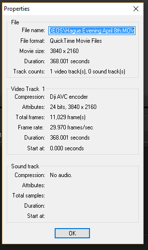

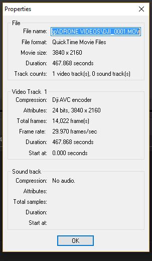

Can you tell us if your X10 is the full version or the trial version? If it is the trial version, then Corel have shot themselves in their collective foot since they have severely crippled it.
But it would also be useful if you could right click on the Mavic clips in the VS library or timeline and copy ALL its Properties here -- or else take a screen shot of the Properties box and upload it here as an Attachment.

Where do I find this info exactly? Sorry, new to the program.aljimenez wrote:As Ken asks, list your video properties and format, in particular bitrates.
