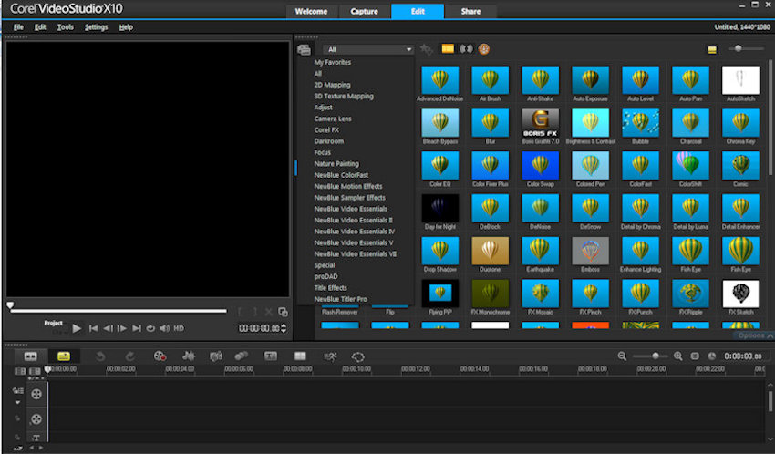

I just downloaded and installed VideoStudio X10 Ultimate. BCC Title Studio does not show up in the FX window, only Boris Graffiti 7. I checked the program files folder in Windows (8.1) and the BCC files are there. Thanks in advance.

From Video Studio FX library, the drop down menu shows a folder called Boris, that should contain the BCC filter.
It should also be available from the All list.

I have the same problem with Boris not showing up in the FX menu.
I have New Blue, Boris FX and ProDAD files showing up in the menu but no BCC titler

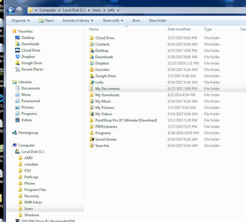

Do you still have the installation folder on your desktop? It should be in there as described by lata above. Or you could just put the following in File Explorer: C:\Users\[YourName]\Desktop\VideoStudioX10_137\64bit\BonusFeature\PlugIns_X64 -- of course inserting your name where if have put [YourName]. See the attached image.

Thank you for the reply, The folder is still on my desktop and I did search search it but for some reason there is only the Graffiti file.
Strange that I seem to be the only one with this problem. Perhaps I should just reinstall

The plugin should show in the FX library under “All” and also under “Boris”.
Does “Boris” exist in the dropdown ( Context) menu?

It seems that those folders were installed in a different directory
This is the closest thing I can find and its in my documents folder

Re: BCC Title Studio missing
Hi Smogg
Yes those folders exist and hold the users files/templates but not the system files I was referring to,
You should find
For 32 bit versions……
C:\Users\UserName\AppData\Roaming\Ulead Systems\Corel VideoStudio Pro\20.0
Rename the 20.0 folder to “20.0 old”
Launch Video Studio.
More details on resetting the program here
http://lata.me.uk/corel/reset/reset.htm
