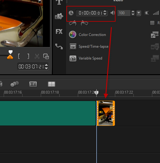

Here's a screen shot where I have two videos and getting the error. The timeline shows evidence of plenty long videos:

Ok. I deleted the two videos and a bmp that was just prior. I then added the videos, and still get the error. The project file must be corrupt some how.
I opened a new project, and added the same two videos to that, and was able to add a transition with no problem. Is possibly a way to evaluate/repair corrupt project files?
[Update]
I tried saving the project as a template, and then open a new project and use the template. Same issue.
[Update 2]
I CAN add it if I hold Ctrl and add to a single clip. I can add it to either clip, but not have it do the default of add to both.

One thing I'm noticing...
I am splitting a clip several times...to cut out some long boring stuff. I am finding that if I do that 2-3 times, that may be when I get that error. Again, the video clips are plenty long.
Maybe it's related to splitting the clip up.

When you select Freeze Frame the scissors are used to cut the clip at the curser position. That creates two clips. The frame at the cut point is then used to create an image, that image being inserted to the timeline, at the cut point
From the position of your curser, cutting MVI-2311 will create a short first clip.
How long is that clip.
From Preferences – Edit tab what is set in Default Transition Effect Duration.
Although the error messages says the video is to short, the transition will be added using a shorter duration.
Again I do not understand why you need to use a transition when using Freeze Frame, although its not wrong to do that.
Just read your last reply, yes the error relates to the cut clips not the full duration of the original clip.

lata wrote:Just read your last reply, yes the error relates to the cut clips not the full duration of the original clip.
That makes sense, and is what I expect. So here are lengths, based on using the freeze frame:
Resulting freeze frame: 10 seconds
Following clip: 54 seconds.
The one second transition gives me the error.
An interesting note: Once I get the error, deleting the freeze frame and then trying to transition between the last of 2308 and 2311 still gives me the error. That is two clips, 2308 is 187 seconds, and 2311 is 54 seconds.

So in above scenario and my real project, it appears that the software will not put a 1 second transition with a 10 second bmp file.

I think the program does not want to put a transition between a freeze frame and a video, and once the error happens, then it repeats even if delete the freeze frame. AT least, that is exactly what is happening to me.

Hi 56, your actions not very clear as I have no trouble adding trans to freeze frames.
Your screenshot isn't clear as it's too wide, zoom your view closer so we can see.
Maybe there is a single frame hiding between those clips.

I just discovered the problem. When I create the freeze frame, at the end of it is a 00.00.00.01 frame. See screen shot:
If I delete that, then I can insert the transition.
It's interesting. I am zoomed in 100% to see that. And then I hit the End key to go to the end of the clip, it stops just short of what appears to be the end, as you see in the above picture.

asik1 wrote:Hi 56, your actions not very clear as I have no trouble adding trans to freeze frames.
Or better still is you capture your action and load to YT we can understand.
** VS has many bugs (like min trans 1sec setting) but I thing yours is resolvable.
Yup. You wrote that while I was writing what I found. Not sure why the single frame is being created. But I have resolution.
Thanks all for your input.

Hi
Ok I got it
You are trying to extend the length of your video by adding an image of the last frame.
You can do that manually without using Freeze Frame.
Navigate to the end of your video, Edit menu “Take a snapshot”
Saves an image to your working folder and places a thumbnail in the library
Drag that to the timeline at the end of your video.
Freeze frame is an auto method of the above, but normally used to stop the motion mid stream.
First time I have heard of using it at the end of a clip, and that seems to be the issue?
Interesting all the same……..
