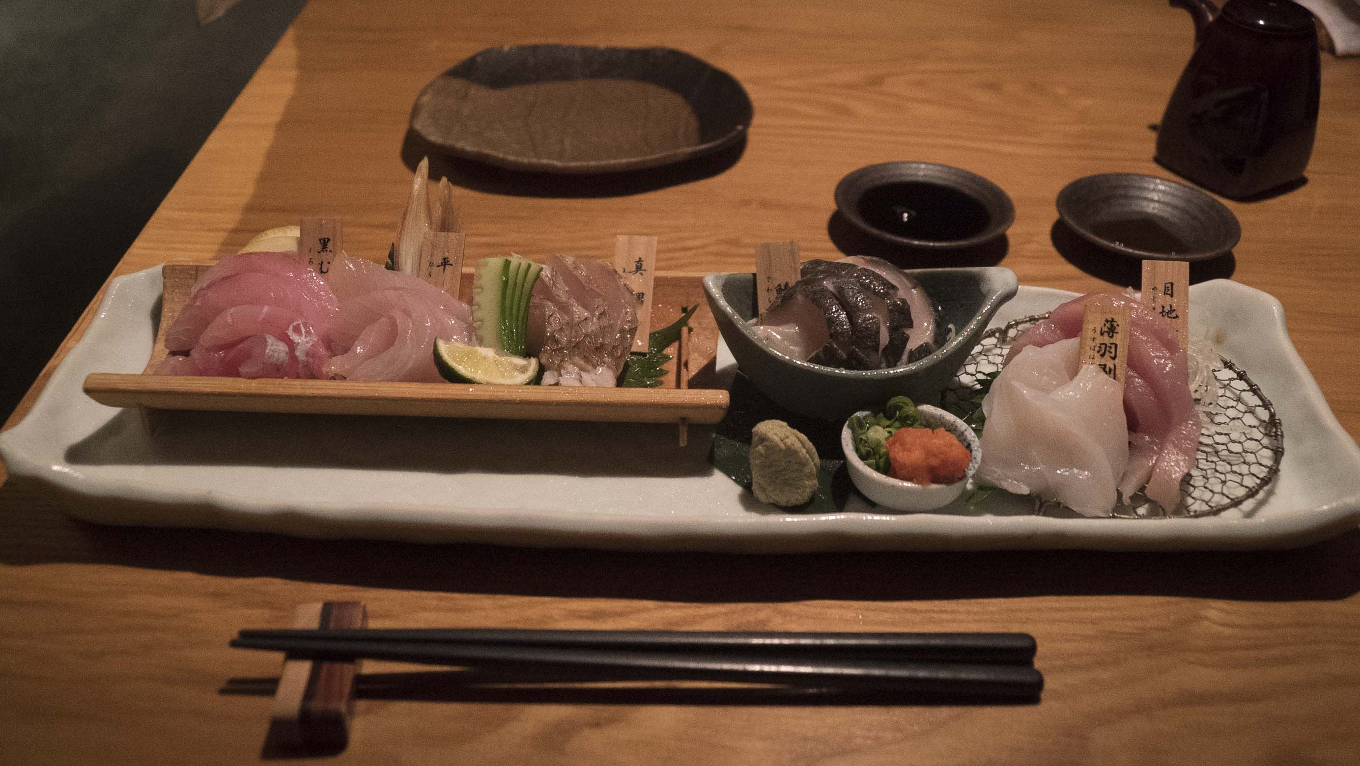

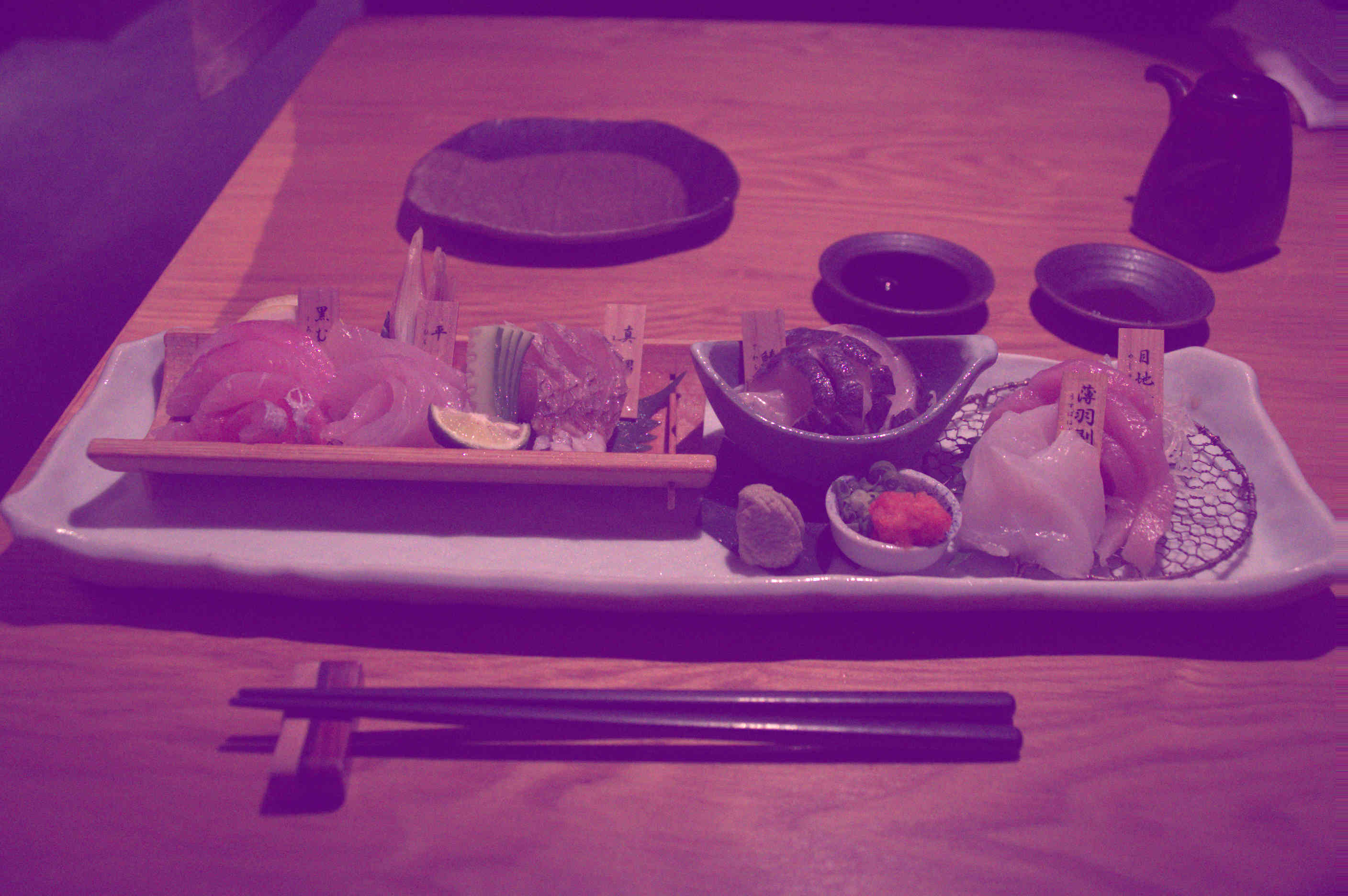

http://info.uniden.com/twiki/pub/images/_DSC2670.ARW is the raw file.
In PSP 9 x64, latest build, the image looks like http://info.uniden.com/twiki/pub/images ... 70-PSP.jpg
In Photoshop CC2017, the image looks like this: http://info.uniden.com/twiki/pub/images ... toshop.jpg
In both cases I made no adjustments to the original image...simply opened then saved as jpg.
Note that A7 raw files look fine. It is just the A7S ARW that has this issue.
