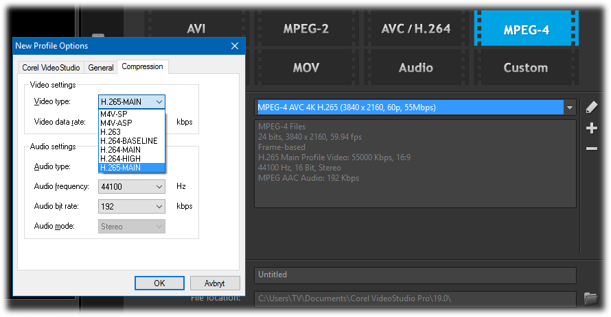

Re: VSPx9 How to export to 4K HEVC/H.265?
Just verified how H.265 support actually works in VideoStudio X9 (now service pack 3 installed):
Requirements:
+ Skylake CPU (tested with Core i7 6700K)
+ use Intel graphics (no nVidia or AMD graphics card - I removed GTX 960!)
Then there is a "H.265-MAIN" video type added under MPEG-4, but You have to add the profile(s) yourself.
Here's a part of a screen shot (if image linking to external source works):
Made some simple tests and it seems slightly slower (like 10-20%) to create H.265-MAIN than H.264-HIGH and trying 4K H.265 with 65, 55 and down to 25 mbps seemed to take about the same time too. Quality wise I can't say, but H.265 is intended to give the same video quality with half the bit rate, so ideally a 32.5 mbps H.265 stream would provide the same quality as a 65 mbps H.264...
Ahem, looking forward to next service pack (packs?) that will support H.265 even with nVidia or AMD graphics cards installed, right!?!
