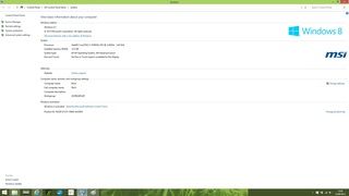

Sorry just to say, I don't have the computer that is on my profile anymore.
I have an MSI laptop
GE60 2PE Apache Pro - running Windows 8.1
Have an Nvidia GTX860M graphics card
