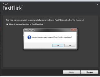

I can't find anything on this Product. FastFlick Instant Slideshow Maker, It came free with PaintShop Pro X7 i just bought Friday, Downloaded X7 ok but in the middle of downloading FastFlick Instant Slideshow Maker i had a power cut, When i managed to get back on to my computer The download had stooped and would not carry on from where it left off, so i deleted everything from put computer and did a CClean to clean the registry. Then Hit the Download Button again to re download from the beginning, unfortunately it keeps telling me>> Are you sure you want to completely remove Corel FastFlick Instant Slideshow Maker and all it's features? and gives me a Cancel or remove button? and if i press Cancel a box comes up saying am i sure i want to cancel installation, but it's not installing anyway?? if i press remove it removes it. and then nothing happens. I'm at my wits end, and trying to get help through Corel is a night mare as i can't find anything on there help about this product so i can't even ask them a Question.

When you are asked if you want to remove the programme say REMOVE - then when that completes run the download .exe file again and it should install on the second attempt - the first remove just makes sure any old bits of programme are removed and do not cause problems.
Fast flick usually comes with Corel VideoStudio - you may get more help with fastflick in the VideoStudio section of these forums
