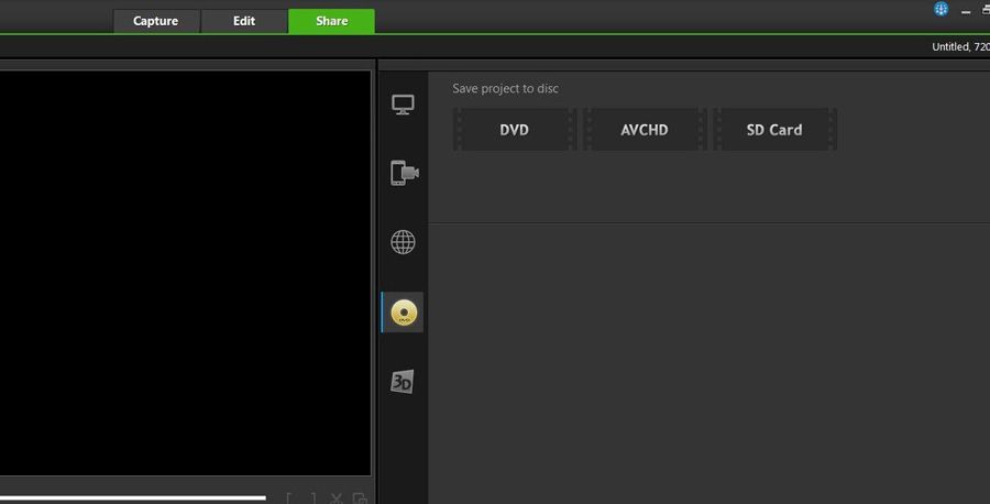

No Blu-ray option in X7
I have a Pioneer Blu-ray drive and I'm using a BD-RE rewritable disk; X7 does not give me the option to write to blu-ray.
It sees my drive as the following: <D> PIONEER BD-RW BDR208D 1.10
Disc type: BD-RE
Anyone know why Videostudio X7 does not recognise that I have a Blu-ray writer?
Many thanks in advance
Disc type: BD-RE

to me there is something missing from your post.
You say VideoStudio recognises your burner - showing you it's make and type number.
You also tell us it recognises the disc you have put in it as a Blu-ray disc
So how do you arrive at the conclusion that VideoStudio is not recognising your drive ?
did you select the Blu-ray option after you clicked 'Share'

Re: No Blu-ray option in X7
Thanks for the reply Brian - you're right about there being something missing from my post - I didn't mention that the Blu-ray option wasn't there for me when I clicked share; so I assumed it was because it didn't recognise that I have one? Is that correct?
I didn't at first but have done so now - same result though
Could it be something to do with that? It's really the only reason that I went for the upgrade in the first place so I'm really keen to get it sorted out - I certainly appreciate your efforts to help me on this

Download file is: VSX7_Pro_PF_x64_2014-10-03
File size on my PC is: 1,878,804 KB
I uninstalled all other Videostudio products (Videostudio 11), but the upgrade still worked which got me thinking that maybe I needed the full version rather than the upgrade??? Can I upgrade to Pro X7 from Videostudio 11, and if so, why did it let me install even after I removed VS 11?

Now alarm bells are ringing
are you saying that apart from X7 you have no other versions of VideoStudio on your computer
Where did you purchase your copy of VideoStudio X7 from ?

Well I thought it was Corel as I just used the link from the trial I think - but I checked my emails and it's from cleverbridge / Corel Digital Media [cs@cleverbridge.com]
I have the receipt if its any use? Paid with Paypal
Came with:
1 2 Year Extended DownloadProtect your investment electronic
1 NewBlue FX - Paint Effects: FVAEffects Plugin electronic
