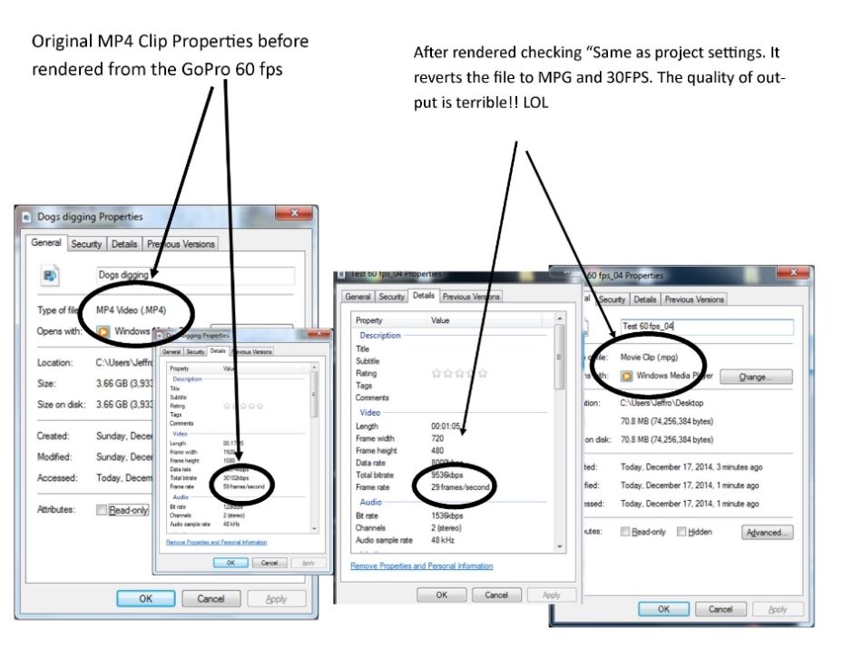

Thank you for the quick reply. I am using x7. I only downloaded a group Codec update for Windows Media after I had no luck getting the rendered MP4 files to play. I can render them in other formats and they play fine. I have tried every Mp4 output that x7 will allow with the exact same result, no video only audio. But to reiterate, I can play the MP4 60 fps unaltered files from the GoPro. Here is the list of MP4 files I have tried via x7:
[img][img]http://i298.photobucket.com/albums/mm257/mccue74/Output_zps895334c4.jpg[/img][/img]

Those Properties boxes you show are from Windows, not from VS. To get those, please right click on a clip either in the VS timeline or in its library window.
The other thing you can try is to click the down arrow to the right of 'Same As Project Settings", and select Same As First Clip, and then render that. What does that give you?
