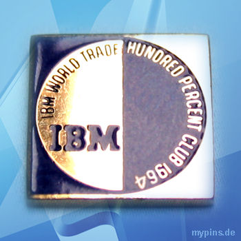

Following scenario: I am a lapel pin collector and present my collection on my site (http://www.mypins.de/ibm). Several of my pins look identical, but have a different year in the text. To avoid taking a photo of every single pin I prefer to have one master photo and have a variable for the text (year).
Here is one example: http://www.mypins.de/ibm/pin_pho/pin1464.jpg
You see the year 1964 - I have copied the picture from another year and over-painted the digit 4 by hand (not good as you can see). Having the full text or just the year flexible would also have the benefit that all pictures look the same.

PS: As you can see the photo was not shot directly from the top; there is an angle to get rid of reflections. But I would then start from scratch and re-create a new master.

Yep - know the layer technique. This is not the real problem. Looks as if I should learn how to use wordart... to draw text in a circle, in a specific angle, along a curve, screw the text horizotally or vertically.. and so on. Would this really work?

So you want to put text on a curve so that it follows the circle.
Easy - tons of tutorials on making text follow a curve.
For the most part it's easy enough on its own. You draw a vector circle. Then with the text tool, hover over this circle and the icon for the text tool will change to a letter on a curve. Click and that links the text to the curve, letting the text follow it.
There's more to get it looking and working just like you want.
