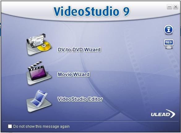

Hello All,
I have downloaded the Trial Version of Ulead Video Studio 9.0
and installed it correctly, but i can't use this software
Always i am getting this Error
and i got it after choosing any choice from this screen
What is the solution?.
Regards

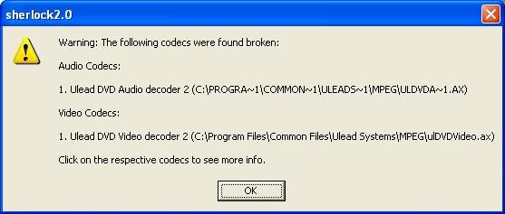

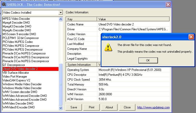

Dear THoff,
I tried your posted software and i end up with this result, I hope you can figure the problem and the solution
Regards

DreamsMaker, it seems that there is some damage to the registry entries for the codecs.
Open up a command prompt, go to the directory shown in the error message (C:\Program Files\Common Files\Ulead Systems\MPEG), and execute the following:
Code: Select all
for %1 in (*.*) do regsvr32 /s %1
Then run Sherlock again and see if the problem has been corrected.
If the files don't exist in the directory mentioned above, then something went wrong during the installation.
