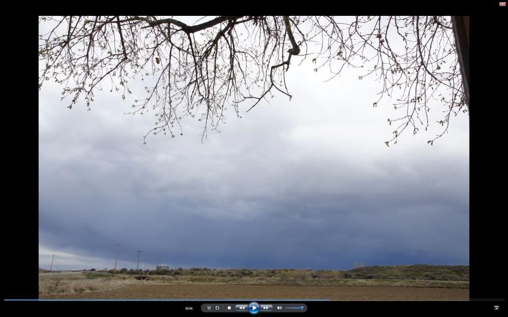

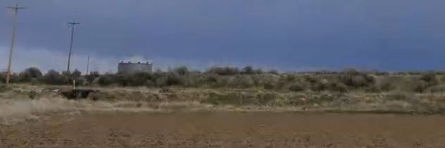

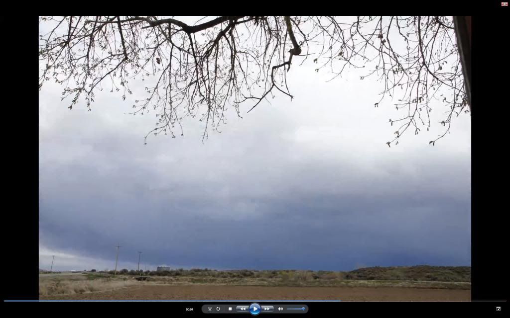

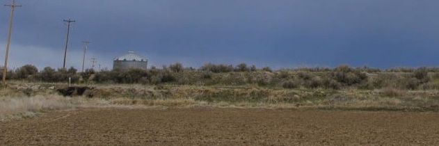

Here's some screenshots of each video.
http://i212.photobucket.com/albums/cc19 ... enshot.jpg

Re: VSX7 time-lapse video mp4 quality issues
Hi the_hefayac
What are you actually taking, I assume the cloud movement?
The playback from the timeline should be good, there may be a stutter but should be even throughout. How much stutter depends on the period between each shot.
Taking a lot of shots at 1 second intervals will produce smoother video than taking shots at 20 second intervals.
Cropping the images is not an option, the two images you show above are cropped differently, you can see movement when switching between each view.
1 / How many images did you take in your sequence.?
2 / What was the timing between each shot?
3 / Timings should be accurate, was that done in camera or do you have an auto shutter release attachment.?
4 / Jpeg images are suitable for time-lapse, no point in using Raw.
As I say project playback from the timelines should be good, the quality of the final video depends on that.
