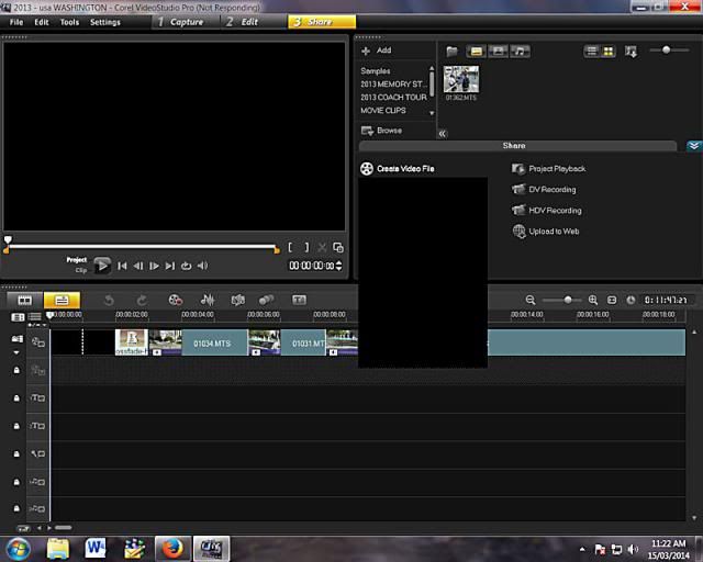

GREAT NOW I CAN'T EVEN GET TO CHOOSE WHICH FORMAT VIDEO FILE I WANT TO CREATE.
Yes I click on Create Video File and I get the 'waiting/sleeping' mpuse pointer for what seems an eternity (actually between 30 and 60 seconds ) and also the top of the screen displays 'Video Studio not responding' as well as a black box centre screen where the menu would display and then the mouse pointer returns to the normal one and NO MENU is displayed.
Over the years (10) I seems to have problems with every version I have owned.
Could someone please create a project containing hundreds of video clips and then see what happens when you select (click on) Create Video File.
BTW when I click on any of the others (create audio file, etc etc) the relevant menu for that option is displayed virtually instantly.
Is there a method of contacting Corel to ask their opinion?

I am now wondering if this extensive delay is caused by the fact that the PROJECT PROPERTIES do NOT match the video clips used.
I did a test in X7 and found that when I changed the project properties to AVCHD then there was virtually no delay when selecting SHARE (remember my video clips are 99% .MTS)
Problem is that in X6 the only project properties available are AVI and MPEG - AVCHD is not an option.
Has anyone else tried/experienced this?
Could someone please do a test. This very long delay experienced is only when there are a lot of .MTS video clips ie >100.
Thanks
Thanks
John a

Re: VS6 takes around 30 seconds to react to Create Video Fil
This has been a long-standing complaint for several versions of VS, ever since the advent of high def video!! And at last it has been corrected in X7. Moreover, if in Preferences > General you tick the box against Show Message When Insert First Video Clip, then you will be able to automatically match the Project Properties to those of the first clip, regardless of whether that clip is high or standard def, AVCHD, mpeg or AVI... And it also means that with X7, you can now also choose Share > Create Video File > Same As Project Properties... A small but significant advance!!Problem is that in X6 the only project properties available are AVI and MPEG - AVCHD is not an option.
Thanks Ken,
You didn't 'say' but can I assume that when the project properties is different from the 'properties' of the video clips contained therein that VS 'needs to' do some converting when selecting Create Video File and thus the long delay?
I have been in contact with Yvonne (for another reason) and when I mentioned the delay she didn't think there was any (but there is).
The following was added shortly later.
I just did a test using VS6 and loaded 900+ SD video clips to a project with "Show message when inserting ..." (which sets the project properties) and then when I selected Create Video File there was virtually NO delay. Yes I realise that the SD clips are much smaller in size than .mts clips BUT I would have thought that there still would have been some smaller delay.
This sort of proves to me that when the project properties is NOT the same as the majority of the video clips then VS does something (conversion?). Am I on the right track? If so then this one can be "put to bed".
With VS7 (and future versions) this then shouldn't be a problem.
John a
VS X10 Ultimate, Paint Shop Pro 2018 Ultimate, Audacity, Panasonic HC-X920M, Nikon Coolpix S8100
I don't think VS does any converting when you select "create video file" - all the rendering is done later after you have set your output parameters. There would be no point in doing any converting at this early stage if the program does not really know what your final output is going to be.
What it might be doing though is perhaps "validating" your source files, that is making sure that the source files are compatible with VS, etc. If you have a large number of files that will of course take some time. I have never worked with hundreds of video files and it is something I would never even consider trying to do. I would break it up into several projects and work on those instead of all of them in one project. One could output each project and "create" video files for each project and later combine all the rendered video file in the final project.
I don't understand what you mean by SD clips.
SD - Standard Definition (720X576)
Regarding "hundreds of video clips" and "breaking the video up into smaller projects". YES I guess I could create lots of smaller projects say one for each day of my trip but I usually create a project for say a subject eg a 14 day coach tour of California which ends up at with a total time of around 30 - 35 minutes after final editing.
My latest project contains 178 video clips (will be less when I am finished) which I don't think is a lot and still I get the delay, see following screen shot and not "not responding" at top of screen which in itself is a concern and the black rectangle where the menu for video file type to render to should be (please note that this is a new project with no overlays, audio clips or transitions).
VS may not be converting but it IS doing a lot of file reading and/or writing when Create Video File is selecting during the delay as the "disk activity" LED flashes continuously during the delay.
BTW I just created a project of just 100 clips (is this a reasonable number?) and there was a delay of around 10 seconds even with just 100 (although a lot less than when the project has two to three hundred).
Anyway this is obviously a 'problem' (see previous replies) which has at last been addressed in VS7 (which expanding project property types to include HD (high definition) video).
John a
Thanks for clearing up my SD question since SD could also refer to SD memory cards and the files on those cards.
I just created a VS X6 project with about 125 DV avi files ( of various length from 20 secs to several minutes). When I selected Share/Create Video file the template selection window opened right away, ie, less then a second. Unfortunately I don't have any mts files to use but then you seem to have a problem even with the standard video files.
I have done several projects similar to yours for various holiday trips from to to 5 weeks in length. I always work with smaller segments covering a few days or even single days. I find it a lot easier and more efficient then trying to wade through hundreds of clips on the timeline/storyline.
BTW, I do get the "Not responding" message ocassionally but that usually clears up after a short while.
