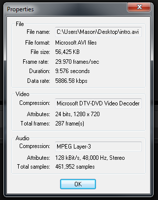

But as you realise, the information you provided gives us nothing to work on in finding a solution. To start with, what type of video are you editing? Where did it come from? To get the properties, right click on one of the clips in the timeline and copy ALL the Properties here, please, or else take a screen grab of the Properties box and upload it here. Tell us something about the editing you are doing and what filters in particular you are trying to apply.

Re: VideoStudio X6 Is Not Running Smoothly
A good example is the NewBlue Motion Effect of Earthquake that I was adding to an intro for a little effect. When I try to adjust the 'knob' it will end up spazzing out and not really accurately changing the magnitude, sometimes leading to a crash. But, the program runs slowly in general.
EDIT:
(sorry, I thought I added this)
EDIT:
