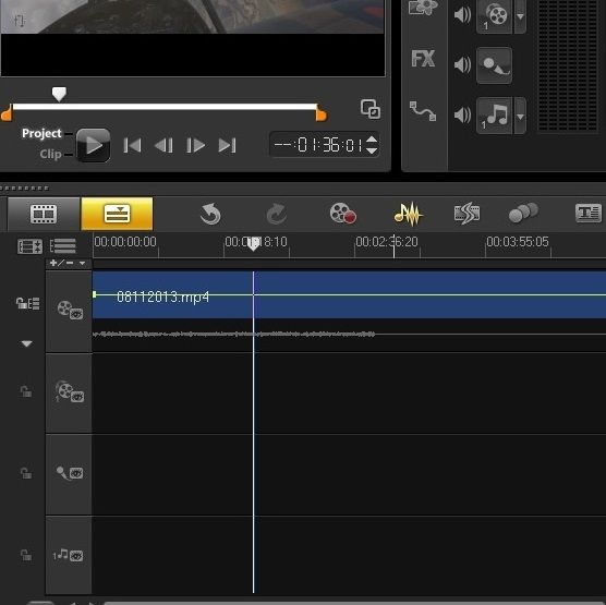

When I import a movie into the timeline, the sound from that movie plays for approximately the first 2-4 minutes, and then cuts out. When looking at the sound mixer in the timeline, I can see where the wave simply cuts out at a point between 2 - 4 minutes (the actual time varies for each movie but it is within that 2-4 minutes bracket for all).

The sound cutting out does happen irrespective of the playback mode (Project vs. Clip). Hopefully the screenshot below of the timeline showing the sound wave gives a better indication of what I am talking about. You can see the sound wave cuts out around the 2-3 minute mark.

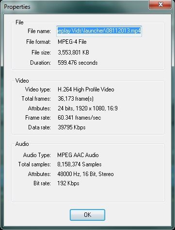

The properties of the example clip is;

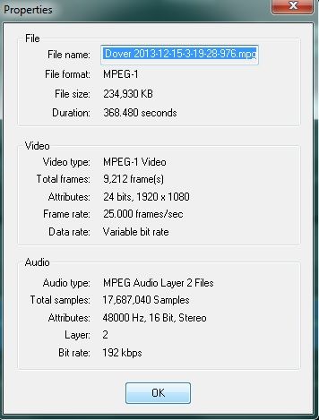

For what its worth the properties for the working movie using Gamebooster screen capture is;

Well the first is Mpeg4, the data rate at 39795 kbps is quite high as data rates go.
Giving quite a large file size. That may be causing problems for VS in reading the video, just guessing here..
Are you able to set the recording properties for the fist recording setting the data rate to 15000 to 25000ish
The Frame rate of 60 suggested to me NTSC yet the second one uses 25fps and that’s Pal.
Where are you, do you use Pal or NTSC?
Video Studio Project Properties should reflect the Frame Rate, then the timeline would use the correct rate, not that that will affect the playback.
The second Video Properties are bog standard Mpeg1, you shouldn’t have any problems with those, however quite a low quality, Mpeg1 is a pretty older format
Although the Data Rate only shows as variable.
But clearly a smaller file size.
I would explore the options of the first recording to see if you have any other options
As I say 39000 is quite high.
