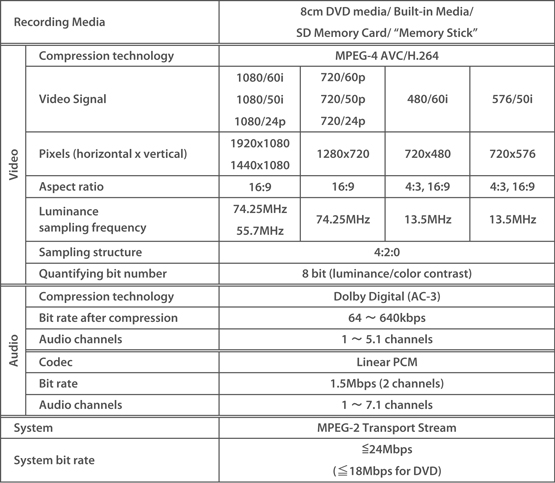

AVCHD : Is a "Disk" format similar to the Blu-Ray format that specifies how devices like Camcorders lay down a file structure on media that can include menus, file naming conventions, chapters etc and what format the media files must be in. The AVCHD specification supports a subset of the H.264/MPEG-4 AVC file format notably 1080 video in 24p, 50i and 60i. In 2011 a Version 2 of the AVCHD specification was introduced to also allows H.264/MPEG-4 AVC 1080 video in 50 and 60p. The specifications of what are acceptable H.264/MPEG-4 AVC file formats is outlined in this table:
