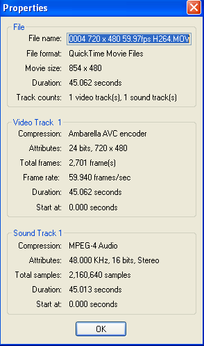

Right click a video clip and select properties the attributes tab should indicate the aspect ratio, as the video fills the preview screen it will be 16:9.
Create an image of the properties window and attach to your post.

The second list above is the list of AVI compressions:
Here is the image Properties window:

Well, I'm not sure where to begin, but I'd like to share some things I've discovered and ask some questions I still have, if you don't mind. I hope this doesn't turn into a long boring rant that causes you to tune out.
Just to recap, I started using VS on some 640 x 480 30fps clips from a Canon point-and-shoot. Immediately there was trouble, in that a simple side roll transition between clips was rendered to an unusual wide-screen aspect ratio, with the aspect ratio reverting back to the normal 640 x 480 after the transition was over. I know enough now (I didn't know anything then) to know that there is going to be trouble with the transition, because, after rendering the unedited clip parts very quickly, it takes a relatively long time to render the transition, instead of quickly, which it should do for just a simple transition.
The cure is not not very satisfactory because it is to turn off SmartRender, which means the FULL video, not just the transition, has to be rendered in its entirety. This is very time consuming.
SmartRender is important in two regards. The first is if you want to produce output to a video file in the same format as the original. If SmartRender recognizes the format, the time to produce the output can be seriously faster compared to having to render the entire video from scratch. The time difference can be like watching a racing car compared to watching grass grow. So to me it's important.
Of course, if you're doing a one time output to a format that is different than the original, I guess that SmartRender doesn't matter since the entire video will have to be rendered anyway. BUT if after producing the output, you find you want to edit the video and output it to the same format again, you would hope that SmartRender would now only re-render the edited parts, not the whole video. This is a second advantage of SmartRender.
Unfortunately, SmartRender seems to be hit-or-miss, not living up to its promise. As you said, if you render a file once but turn off the computer, the next time you start the project, you start from scratch and when you produce an output, the output always has to be rendered from scratch again. SmartRender has no memory from previous sessions. This might be expected, though it would be nice if SmartRender would ask you if you want it to remember for the next time (wishlist for VS7?).
BUT what I don't understand, and maybe you can clear this up if you know the answer. If I share to an output file usually the entire video file is rendered. Obviously, SmartRender didn't "like" the properties of the clips. ok, I understand that. But then, for a test of SmartRender, I can immediately output the file again with no edits, to the exact same format as the first time. Since the file was just rendered and there were no edits, I would think that SmartRender would know that nothing has changed and output the file in record time. But instead, the entire file is usually rendered in its entirety from scratch. Very Frustrating! Do you have any idea what's going on here???
Now, I can't say that it happens like this for every clip I have. I have clips from three different cameras and I can't remember all the results. I do remember that for maybe one or two clips, SmartRender remembered that it just rendered the entire video and produced a second identical output file very quickly, but for the most part, it seems it doesn't remember that it previously just rendered the same video output.

The strange change in aspect ratio is still a mystery to me, still think it’s a Non square pixel rendering issue, disabling Smart Render did the job.
