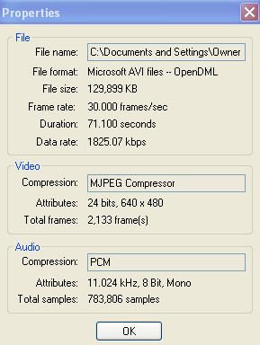

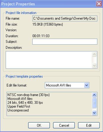

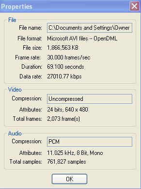

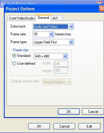

Thanks for the welcome and your reply. Here are the details for my two avi 640 x 480 clips:
1st Clip:
Project Properties:
OUTPUTS:
1) NO TRANSITION between clips:
a) Using "same as first clip" option
Result: Output is good. Video quality as good as originals and file size is small (relatively). File Size: 129MB
b) Using "use Project Properties" option
Result: Output is good. Video quality as good as originals but files size is over ten times as large. I notice that the data rate is much larger than the original clips'. File size: 1,900 MB
2) WITH CROSSFADE TRANSITION between clips:
Result: Output is good EXCEPT during the transition, when the video format changes to widscreen. After the transition is over, the video format changes back to normal 640 x 480. ** The change in video format during the transition does not occur in the VideoStudio preview screen but does occur when I watch in VLC player or UMPlayer. File size: 141 MB
Result: Output is good. The format stays at 640 x 480 for the entire file, including the transition, but the file size is big. 1,866 MB
I'd like to be able to use the "same as first clip" option and have the transitions stay at the video size (aspect ratio) as the original clips, or use the "use Project Properties" option" if the file size can be reduced to the same as when using the "same as first clip" option.
Any suggestions?
Thanks.

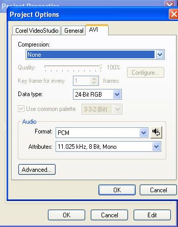

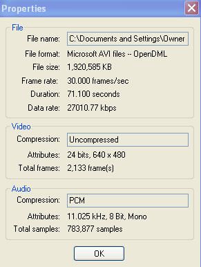

The reason you are getting such huge files is that you are using the uncompressed (or full) version of true AVI. That will produce around 65 GB per hour of video. What you need to adjust in your Project Properties is on the third (AVI) tab. First, in the Compression window you need to click on the drop down arrow, and select MJPEG as the output format. Then you should get a bitrate window where you can set a rate similar to your original video.
Ken Berry
Re: Huge File Size When Using Program Preferences in VideoSt

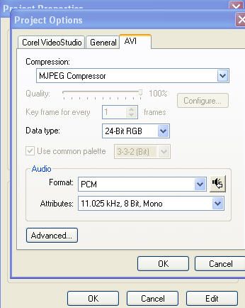

If I did it correctly, the Config option is greyed out:
I think that Configure button relates to the greyed out quality setting to its left...
Have you tried rendering with that MJPEG setting? If so, what size/quality file does it produce?
Ken Berry

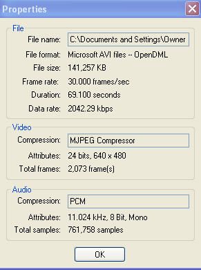

The file size is good, only 141MB, the same as when using the "same as first clip" option. But it still suffers from the problem that during the 2 second crossfade transition, just like when using the "same as first clip" option, the image switches to widescreen for the duration of the crossfade (When the crossfade is over the image goes back to 640 x 480). When I set the "Project Properties" option with no compression, I get a huge file (as we've discussed) but the crossfade stays at 640 x 480 for the whole file. I should mention that the transition video problem is seen when viewing the output avi file with UMPlayer or VLC Player, but I just tried Windows Media Player and the crossfade is always ok, staying at 640 x 480. I'm hoping that there is a way to create avi output files using the MJPEG compression that can be viewed ok on the other two video players I mentioned.
I also noticed that there are many other compression methods that can be selected besides MJPEG. Would any of these be better to use?

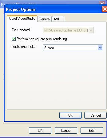

It may be Non Square Pixel Rendering that is kicking in over the transition.
You video may not be use NSPR so this setting is ignored, but not for the transition it may be used, Title clips may also move out of position.
From Project Properties –Edit “Alt+enter” deselect “Perform Non Square Pixel Rendering”
Then try rendering again does the transition stay as 4:3
I have to say that this option is normally selected, it is only on the odd occasion that it needs deselecting.
Just clutching at straws but……
Lata,
Thanks for the reply. I unchecked it as you suggested, but unfortunately the video still changed aspect ratio during the transistion.

I'm using original clips that are avi and rendering to avi format (see screenshots above).
I have Mjpeg 640 x 480 clips in avi format and choose Project Properties as Microsoft avi. I'm playing the rendered videos in UMPlayer or VLC Player.
I tried what you did using my avi clips. I changed Project Properties for Mpeg, instead of Microsoft avi, and rendered to Same as Project Properties. My output file also had no problems during the transition.
But I want to render to the original format of the clips, which is avi. Rendering is much faster since there is no conversion to do (except during the transition), and the video quality is not degraded at all.
