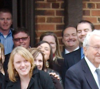

I discovered a VERY serious problem with this version, and switched back to 1.0.1.10. You have to zoom in to catch it, but the new version added gashes to my photos. Thank goodness I caught this before returning the finished pictures to my customer. All my photos were affected by this flaw, and most photos had several of these. There is a vertical aberration slicing right through the middle person's face. See this (heavily zoomed) sample: Image

I can confirm this bug. Some pictures are broken in 1.1.0.30. However, turning OpenCL off helps.

So, does it mean it does only occur on systems where opencl is active ? And, that deactivating opencl will kind of solve it ?

Yes, deactivating OpenCL solved the problem on my system.

for me the bug is camera dependent. with a 5d mkI there is no problem. but with the 5d mkIII I get the Line artifacts. :( the one you need speed on right :)
