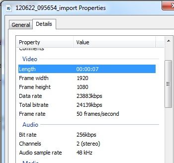

Re: distorted audio playback.
Going to go out on a limb here (as I can't get the info right now). I have some clips here that he shot with the same camera and settings as the other one, so I'll assume they have the same properties if that's any use...........
If this is of no use, I'll get the info tomorrow.
joe
joe
Thanks, but that is a Windows read-out which doesn't tell us the actual format of the audio -- I suspect Dolby, but it could also be some other format. So yes, get back to us with the information given in VS under Properties.

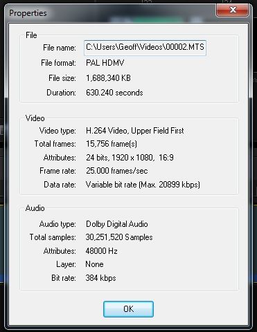

Here's the info......
joe
joe

Well, those properties indicate that the video is stock standard full AVCHD, and VS X4 can certainly handle Dolby audio with no problem, so I really don't know why your friend is having the problem.
But one thing puzzles me -- or rather two. In the first photo you posted above, the frame rate is given as 50 fps, and the audio bitrate is 256 kbps. Yet in the second, the frame rate is given as 25 fps and the audio bitrate is 384 kbps. The frame rate business is perhaps explicable by the possibility that Windows reads an interleaved frame rate where 50 represents all the fields involved per second (one field = half a frame). But the difference in the audio bitrate is perhaps more puzzling. I would have been expecting 256 kbps as being normal, but 384 is still within the capacity of VS to handle.
Ken Berry
Hi Ken
The two grabs are from different clips, but I think you're probably right about the frame rate explanation, as they are both definitely PAL footage. The only thing I thought (with my zero knowledge of VS), is if VS is somehow using the wrong audio codec, and if there might be a way to point it at the right one? (which is presumably being used by the other editing program and windows media player for it to play back properly in those).
