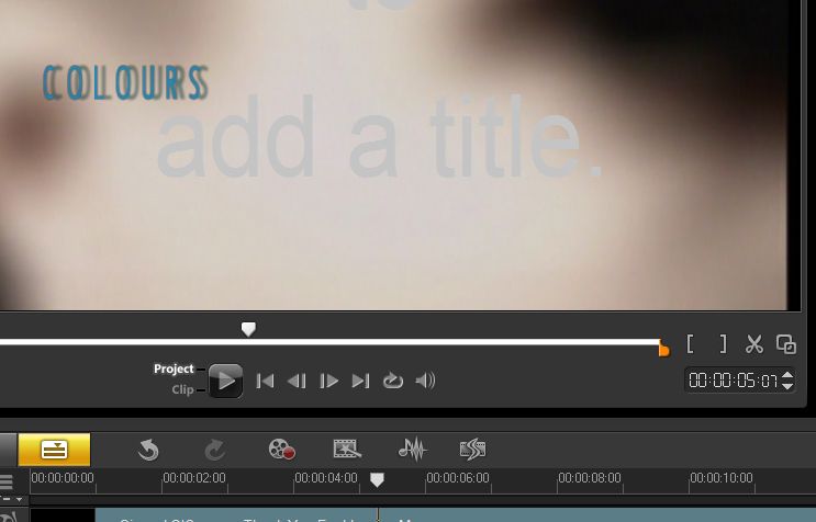

I'm a user of Corel VideoStudio Pro x4 and recently found this feature not working properly. I'm trying to drop a blue shadow against the font. I'm getting a black shadow instead.
Please see here:
And this is what I'm getting at the end:
Previously I worked with Corel Videostudio Pro x2 and that feature was working perfectly.

It might be my eyes, but to me the drop shadow in the bottom photo still looks blue-ish... It is against a lighter background than the top photo and this could account for some of the blue appearing to be washed out...?

Well, it seems too washed out in my opinion.

In the Border/Shadow/Transparency box you show above, the box that shows "48" adjusts the transparency of the drop shadow. The lower the number, the more solid the drop shadow is. The number to the right of that how soft or hard the edge of the drop shadow is. Just as an experiment, set the left box to 10 and the right box to 0. If you have a blue color selected in the color selection box (which is what you show above), you should get a very obvious bold blue drop shadow. If you are not getting blue, yet blue is selected in the color selection box, then something is broken... can't say what at this point.

Well, I've done what's been recommended to me. I've tried setting the left box to 10 and the right box to 0 and instead of blue I'm getting black colour. I also have VideoStudio Pro x2 and this seems to be working okay.
I've also done a software reset, but to no avail.
No idea what is going on here...

It made no difference whatsoever. It fades into a black colour.
