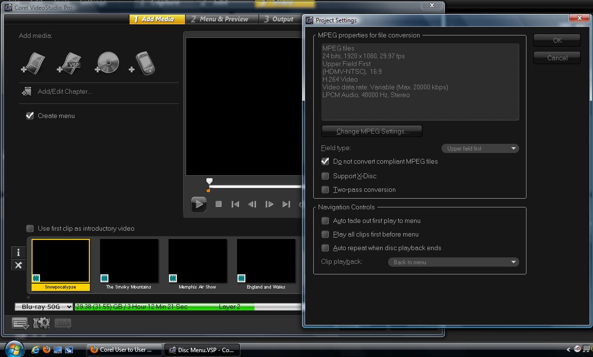

Here are my current project settings:
  • NTSC drop frame (29.97 fps)
  • MPEG files
  • 24 bits, 720 x 480, 29.97 fps
  • Upper Field First
  • (DVD-NTSC), 16:9
  • Video data rate: Variable (Max. 8000 kbps)
  • LPCM Audio, 48000 Hz, Stereo
And here is a screenshot of my Share > Create Blu-ray properties: click.

    • MPEG Transport-Stream Files
    • 24 bits, 1920 x 1080, 29.97 fps
    • Frame-based
    • (HDMV-NTSC), 16:9
    • H.264 Video
    • Video data rate: Variable (Max. 18000 kbps)
    • Audio data rate: 384 kbps
    • Dolby Digital Audio, 48 KHz, 2/0(L,R)
  2. For the final project which contained all five movies -- Share > Create Disc > Blu-Ray > Project Settings:
    • MPEG files
    • Upper Field First
    • (HDMV-NTSC), 16:9
    • H.264 Video
    • Video data rate: Variable (Max. 20000 kbps)
    • and nothing was checked except for the option to not convert compliant MPEGs
Thanks again for all your help with this, Ken! You're the best!

StitchedPigeon
Nice to hear you managed to burn the disc.
just a comment on your video properties.
1 / First if the original videos are HD then their properties should be used to create the final video's, the five videos.
2 / The properties of the five videos shown in the first list should be used as the settings shown in the second list.
3 / Edit the burner module Project Settings to match the video files properties.
Comparing your settings..................
Changing Frame Based to Upper Field may impact on quality
By using 18000kbps the final file sizes will be smaller
By using Dolby Digital again the file sizes will be reduced.
By rendering settings like for like should reduce the render times
I have looked over the older posts but did not see any reference to the original video files properties, maybe i just missed that info?
