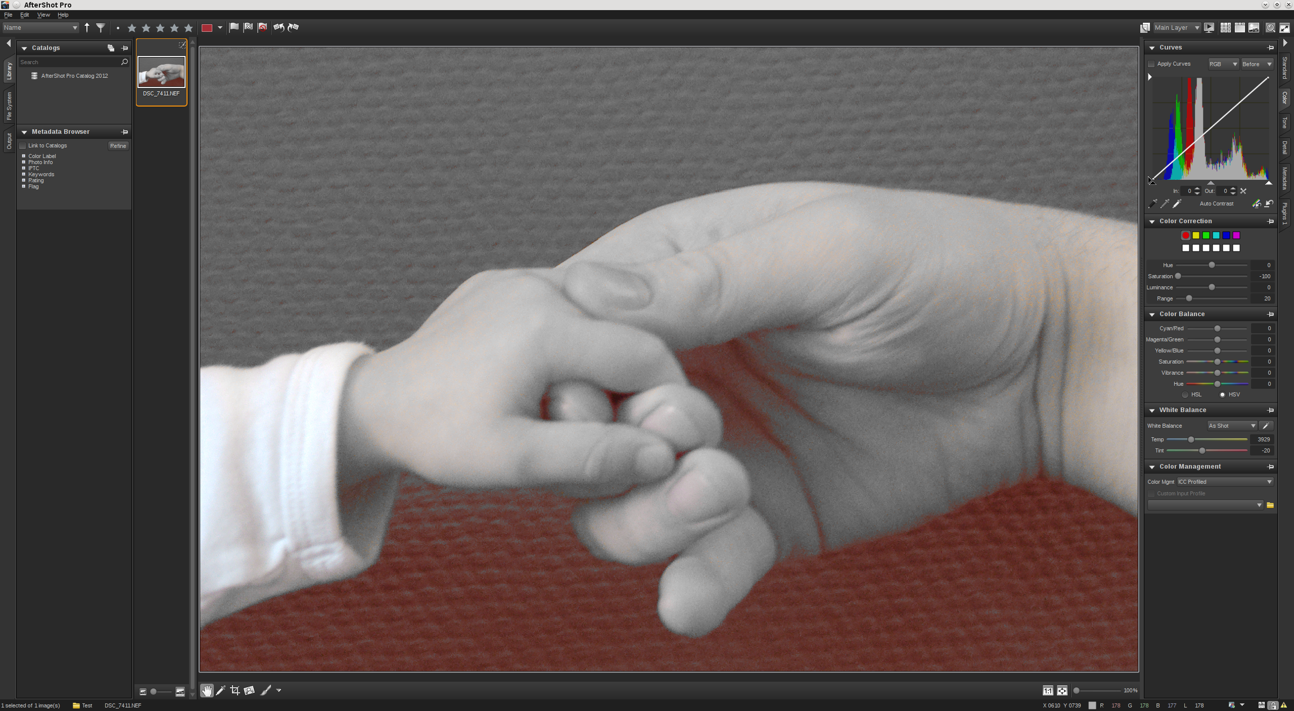

For example I have a test picture where I moved the saturation for red to -100. The strange result can be seen here:
http://www.pontohonk.de/screenshots/asp_saturation.png
I expect to see no color at all because the background is only red. But somehow only the upper part got desaturated.

ponto wrote:Where can one report Bugs?
Not sure if the SurveMonkey page for AS is open yet...
I'll ask Jeff.
A related question: Does ASP use the lab color space internally for such operations?
No, RGB. Only Plugins use LAB when they explicitly request it.

ponto wrote:A related question: Does ASP use the lab color space internally for such operations?
Unlike Bibble5 there is no selection for working space if that's what you mean. If you inspect the detail on selective copy or save settings, it says prophoto rgb, which was the bibble default. Of course this could be a no longer used remnant.

gregglee wrote:
ponto wrote:Of course this could be a no longer used remnant.
Very much likely as the internal working space is not regular ProPhoto but linear ProPhoto.
