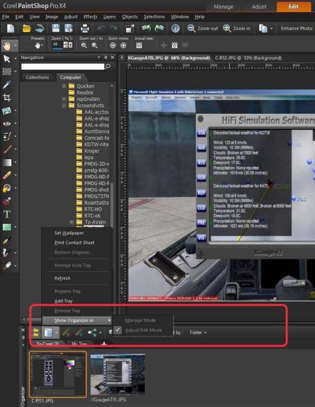

Just wondering if you are using the organizer in Edit mode like this now?

knelis
Posts: 5
Joined: Tue Dec 06, 2011 6:55 pm
operating_system: Windows XP Pro
System_Drive: C
32bit or 64bit: 32 Bit
motherboard: dell c474
processor: celeron 346
ram: 1 gb
Video Card: E2340
sound_card: none present
Hard_Drive_Capacity: 150 gb
Monitor/Display Make & Model: LG 2340
Re: File closes when opening new file X4
Post by knelis »
That's the way it works now indeed.
I don't know if it was the update, that fixed the problem??
I've tried to get this workspace for a long time, but suddenly it shows good now :)
