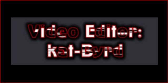

I am having a problem with titles. There is no video involved currently. I have experimented with many exports, including custom, mpeg, wmv, same as project settings, and I get the same results each time. The font, colour, size, etc. are irrelevant. There are "bits" missing out of the text.
I have used VS 10, 11, X2 and X4 so I thought I had a clue. Apparently not. :roll:

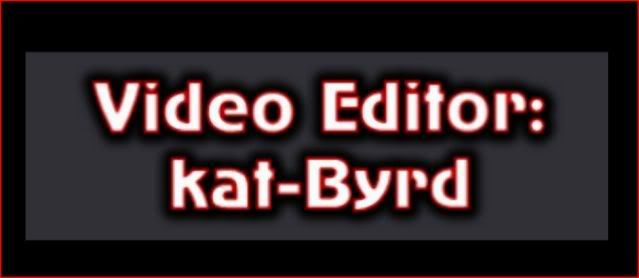

Here is a sample of how the title looks on the preview:
http://i286.photobucket.com/albums/ll11 ... render.jpg
This is how it looks after rendering:

I have still not solved my problem or figured out what is wrong.
I installed the codec packages suggested above. I upgraded to Windows 7 Ultimate from Vista Home Premium. I also removed Pro X4 and reinstalled ProX2. Unfortunately while Pro X2 couldn't read the .vsp file, I experimented with titles and Pro X2 exported the titles that are rendering with the broken text in Pro X4 without a problem. I uninstalled Pro X2 and reinstalled Pro X4. Still have the same problem. Also any of the premade title cards available in Pro X4 show broken text occasionally on the time line. By way of experiment, nine of the ten premade title cards I dropped into the title time line rendered with broken text.
I should have mentioned previously that while the preview plays without the broken text, I can run the scrubber over the title cards and see the broken text, though not every time. It's random on preview but always on render.
I am at the point where I will make my title cards on a photoshopping program, import them as jpgs, and render the video projects I have completed to date. Then I will have to remove Pro X4 and return to Pro X2 if I can't solve this problem.
I would also like to understand what the codec has to do with titles when there is no video involved. I admit I won't understand all the codec issues and I might not understand that they're related to still images not just video. Other jpg images aren't affected by this problem. It is only the text on titles.
Any other ideas are greatly appreciated. Thanks!
