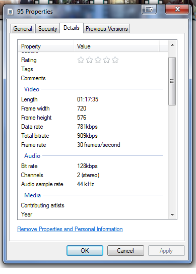

Re: Editing home movies help please, what format?
Sorry for the late reply havent had time to edit over the week,
Ok so ive scrapped the idea of using my ripped wmv. files and have just now imported the Disc into the timeline,
It is a dvd disc not a data disc,
However i imported the disc and its split into the chapeters that have been made for the dvd, when i set the in and out points for the clip i wanted the first time it saved / rendered the whole dvd which took ages, and ive just tried to crop the clip again and its not been cropped the way i wanted to, this time it wasnt the whole clip but went further past where i wanted it to end.
Am i doing something wrong? ill try again now.
EDIT...
Yeah the timeline has splits for the chapters is it? it runs like it would do when played normally, but before i was double clicking a clip and setting the in and outs on the smaller pop out window... now im doing it on the time line it doesnt seem to be cropping when i want i to..
Heres a screen shot of what you originally wanted to see:

Your original video files are mpeg2.
Choose Share Create Video File – Same as first Video will create a video file to your original properties.
Now it would be nice to know what these properties are,
Right click a clip in the timeline and select properties, what are they.?
The length of the project is also important as this affects the Bit Rate being used, how long is the project?
Ok so ive imported the disc and ive saved the project...
The part where im stuck is editing the clip in the timeline... if i set my in and out points, and go to create video file its saving the whole thing...
After ive set the in and out points of the clip i want how to i make sure thats the only thing that will be saved?
I know im doing something simple wrong... im just not sure what.
I posted a screen shot up is it not showing?
Here it is again:

The size issue..... example "my christening" 26m ... 935mb... i think im going to have difficulty getting all the clips onto 2 dvds...
But if thats the case its fine, i just want to make sure im editing it all in the right format this time so i dont have to re-do it again.

Are the other 5 clips roughly the same size, or bigger or smaller? A single layer DVD can hold 4.3 GB of video, so if the other clips are roughly the same size, they will all fit comfortably on two DVDs.
But if they are a bit too big (i.e. over 8.6 GB in total) then you could -- instead of choosing Same As First Clip -- choose Custom instead. Then leave it as mpeg-2 format, but on the Compression tab, when you click the Options button, reduce the bitrate a little down from the existing 4494 bps to, say, 4000 kbps.

Hi
Just a quick observation
Your original video file is using a bit rate of 4494kbps.
This will allow you to create a disc of approximately 120 minutes.
The rest of the properties are standard Mpeg2 suitable to burn a DVD
Be assured you are using the correct settings to burn your disc. Please say how long your completed project runs for.
Good night Ken.
Good night Ken.
