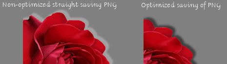

btw the line doesnt show up in the program for me only when i use the file on a 3d virtual world then u see the line ... (this version is first time its ever happened)
so you may not be aware its there
Here is a sample of before and after using the optimizer if there is anything I can do to help sort this I would be more than willing to help.

Re: PNG problem in PSPX4
Well its not even a .pspimage issue ... its anything that has transparency or in my case any png file. Here is what I do ....
1. open pspx4 ... go to edit tab
2. open png file
3. click save
4. view inworld on my avatar and voila .. the ugly white/grey line that wasnt there before
5. go back to psp and save using the png optimizer
6. reupload to avatar and voila .. line is gone
I have never used the optimizer before on any other version of psp .. so I find this sooo odd.
I do have email into corel and have had first reply which was to reset back to factory default settings .. did that .. made no diff. So waiting on further discussion.

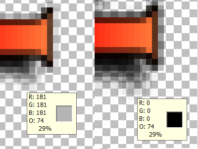

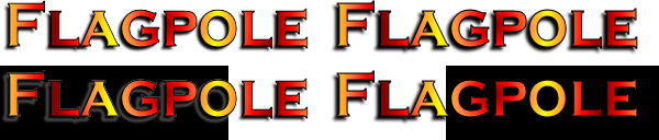

He's right. I believe this is a bug. I think maybe nobody saw it because we all save png with the optimizer. but thinking back i have seen this in the wild now. it explains something...
anyway here is an image http://nigelcoldwell.co.uk/test/pngissue.png
the two images at the top are the same image, text with black(0,0,0) drop shadow, they are just saved in different ways, on the left using the default options and on the right using the optimizer 24bit colour and alpha channel transparency.
the images above are then show below on different backgrounds. as you can see the colouring has been changed the colour tends to white as the opacity tends to zero.
it is perhaps even more clear here http://nigelcoldwell.co.uk/test/pngerror2.png
it's the same pixel that the colour picker is showing in each half of the image. the colour from the black drop shadow should be black with differing opacity.
as far as i know saving png with the default options should be lossless, and has always been. this colour artefact seems like a simple coding error, transparency overflowing into saturation, typo, or whatever, but either way it is a BUG
edit: thinking about it it may be a corruption of the logic used for single colour transparency where it has to assume a background colour and a threshold in the event that the image contains partial transparency. but this is definitely not appropriate when saving with full transparency.
