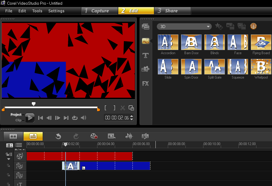

I probably should have done this on my earlier post, but here's a screenshot. For the meantime, I will find the other post that you mentioned regarding this topic. Thank you.
In the screenshot, you can see that the red clip is ahead of the blue clip that is placed on the overlay track1. The transition is placed before the blue clip. I wanted the transition to work only on that particular area of the frame that the blue clip occupies, but it affects the whole screen.

This is a know problem with certain transitions used in overlay tracks. About the only ones that work correctly in overlay tracks are the fades. There are some others for example those in the Wipe category. They will not affect the lower tracks.
Now looking at your screenshot you're not transitioning between two clips. This is a little different. I've also noticed the same thing when using a transition placed at the start or ending of a clip, that has no other clip preceding or following it. I think VS treats it as the only clip in the timeline. In this case the Fades do not work as you would think. I agree that it should not use the entire timeline, but for now that's what happens. While beta-testing, I brought this to Corel's attention, but they apparently don't see it as a bug, or choose to ignore it.

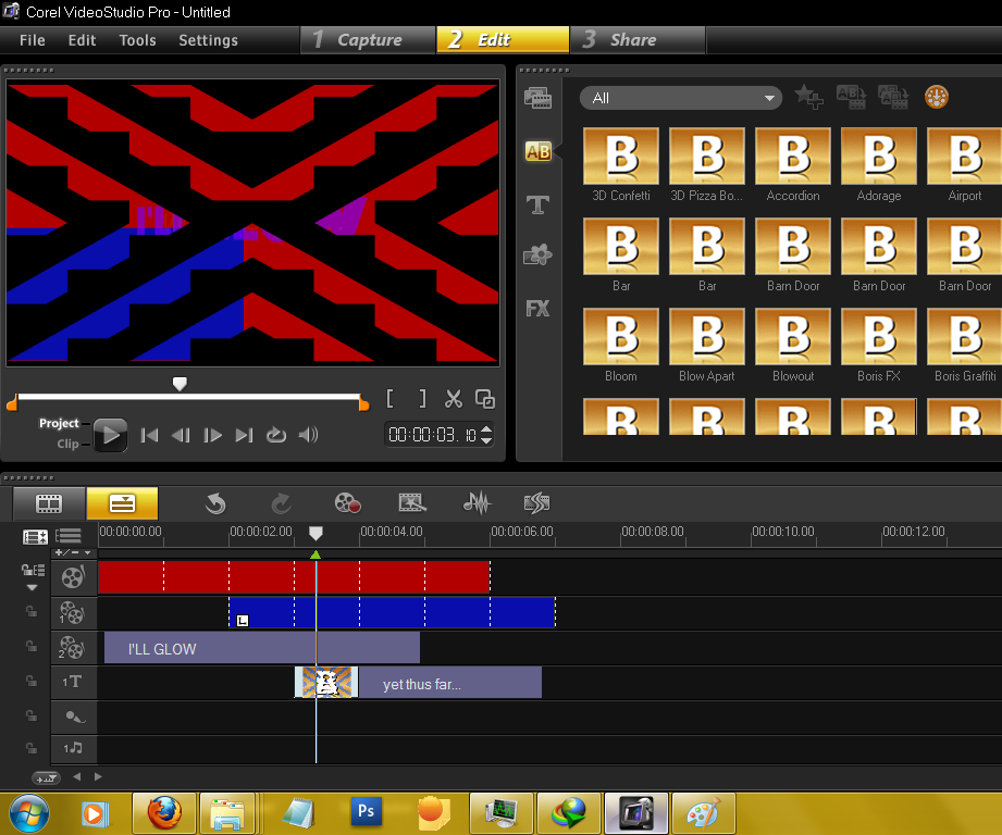

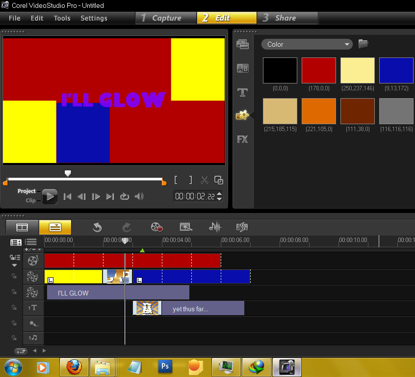

UPDATE: I forgot to mention that this phenomenon also happens with titles.
Ron P., I also noticed that the fades affect the entire frame when I tested it with the titles. I also tested placing a transition between two clips and although it produced interesting effects, it did not achieve what I wanted. (see attached photo below)
Thank you for your insight. Maybe VSXP5 will include a "fix" or workaround for this. After all, they didn't overlook the function of putting transition in the overlay tracks.
