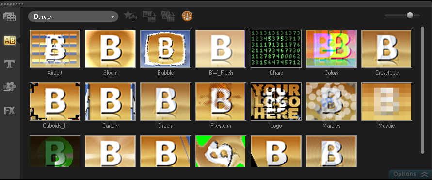

Here are some screenshots so you get what I mean:
This is the burger transitions. Weird. They don't have duplicates. I also noticed that "My favorites" and "Wipe" category don't show duplicates.

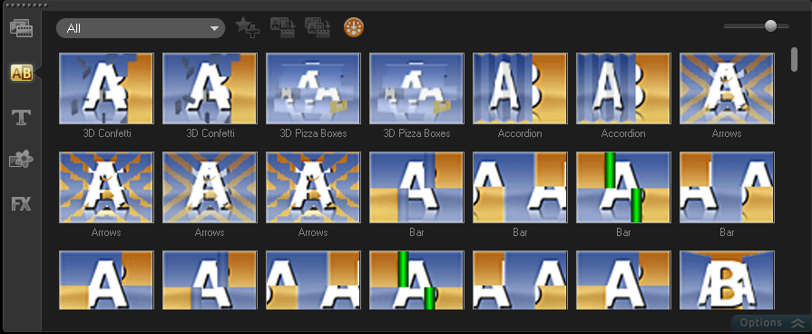

This is All the transitions. Notice that "Arrow" and "Bar" have multiple copies. I also noticed that the burger transitions are absent in "All" category.
I checked my Vft_plug folder and there are no duplicated files. The " phantom duplicates" only occur in the transition window. So what I want to ask you guys is this: how do I make those duplicates disappear?

In regards to duplicates appearing, that is from multiple install attempts with various plug-ins. I've had this happen with New Blue FX. The remedy is to navigate to C:\Users\Ron\AppData\Roaming\Ulead Systems\Corel VideoStudio Pro\14.0 and rename the 14.0 folder, or you can delete it. I recommend renaming it first, just in case things don't go according to plan. Then launch VS again, and it will rebuild that folder correctly.
Note, if you have any personal libraries, Back them up first, as you will loose them. Also the name in red in the above file path, would be replaced with whatever user name you have.

So I did what you instructed and it fixed the problem.
The burger transitions are now working quickly (no more lags) and it even showed up in "All" category.
