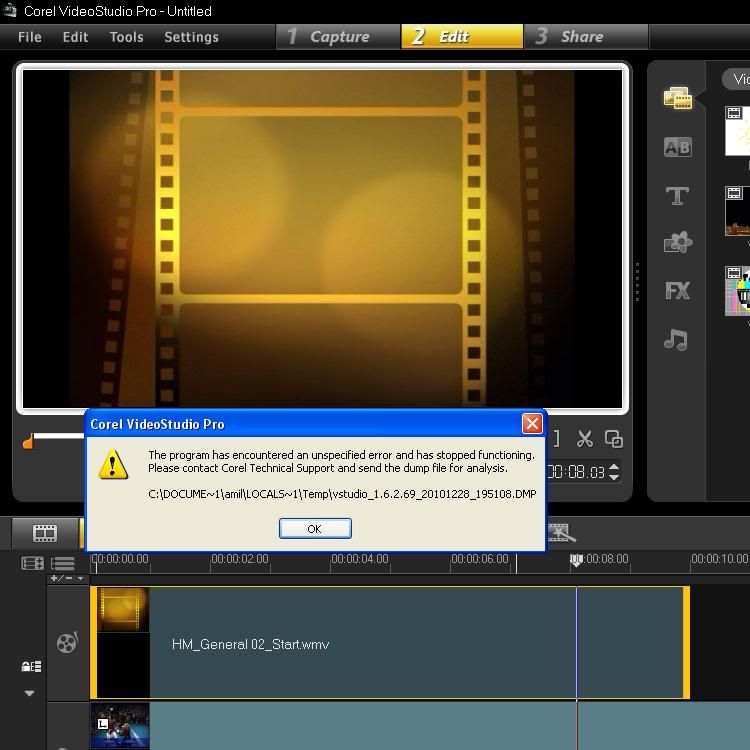

I thought i was getting this message when i enabled ripple select all but now i am randomly getting this message anytime i am using VS. I use VIDEOSTUDIO PRO X3 and i believe i have updated the necessary updates for it . After i get this message, it shuts down VS and i have to restart the program.

Obviously that error message doesn't tell much. Neither do you.
Please read the following and supply the requested info.
http://forum.corel.com/EN/viewtopic.php?f=1&t=8959
Did you send the dump file to Corel?

Re: VS PRO X3 error message that shuts down the program
Describe your problem: dmp error message , picture up above.
Properties of your source files, including video, audio, image files (format, file size, where did you get it?): Total Media Extreme
What devices are involved and their mode of connection?: Hauppauge HD PVR
Project Properties (important): DONT KNOW WHERE TO GET FROM
Output format (file, DVD, VCD, SVCD):M2TS , TS,
Output Properties (cogwheel in lower left of burn screen):
PAL or NTSC: NTSC
Error Codes (if any): LOOK ABOVE THE SCREEN
Product Version: e.g. VS10, VS11+, VS X3 Pro, DVD MovieFactory, DVD Factory 2010, ect.. VS X3 PRO

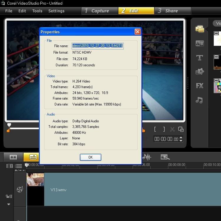

I am sorry to have to say that you still have not told us anything much more than your original post!
We can see your immediate problem in the message. But we need to know more about the video you are editing. You say "Total Media Extreme" as the Properties, but that tells us nothing unless we too happen to have that program/hardware. Please right click on one of the files inside Video Studio -- either in the timeline or in the library window -- and copy ALL its Properties here please.
Please also describe exactly what you were doing by way of editing, and what you intend to do with the video -- e.g. burn it to DVD, Blu-Ray or what. (You say your output format is .m2ts or .ts, which may be correct, but I suspect that what you are talking about is the output format of the Hauppage device.)
Hoe did you capture the video from the Hauppage? It might seem obvious to you, but I -- and I suspect a lot of others here -- don't have that specific device, so we just don't know...

This is in the library file properties. I am getting this error message popping up randomly when i insert this file to the TimeLine.Ken Berry wrote:I am sorry to have to say that you still have not told us anything much more than your original post!We can see your immediate problem in the message. But we need to know more about the video you are editing. You say "Total Media Extreme" as the Properties, but that tells us nothing unless we too happen to have that program/hardware. Please right click on one of the files inside Video Studio -- either in the timeline or in the library window -- and copy ALL its Properties here please.
I am editing using VS pro x3 and want to save the file it to my Hard Drive after i am finished.Please also describe exactly what you were doing by way of editing, and what you intend to do with the video -- e.g. burn it to DVD, Blu-Ray or what. (You say your output format is .m2ts or .ts, which may be correct, but I suspect that what you are talking about is the output format of the Hauppage device.)
I capture the video from a Hauppauge HD PVR device using Total Media Extreme software . When capturing , i am using M2TS format.Hoe did you capture the video from the Hauppage? It might seem obvious to you, but I -- and I suspect a lot of others here -- don't have that specific device, so we just don't know...

I think it should be the same in Win7 as in Vista... WIth VS running, bring up the Task Manager, go to the Processes Tab. Now locate vstudio.exe, right-click on it and select the Priorties option, and it should by default be set to normal. Try bumping up the priority to see if that helps with smoothing out your preview playback. There's even one option of Real Time.
However VS has a real problem with the 60fps (59.94fps), or 50fps for PAL. It just does not interpret those correctly. It will treat it as one-half of the actual rate. So the resultant preview or video will not be smooth.

... And as I just said in your other thread, Corel has been unable to provide an answer as to when they might be able to produce a patch or version which can deal properly with true 60 fps progressive video...
