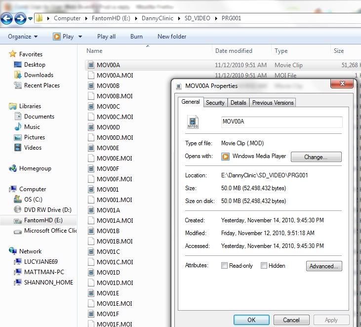

Yea I thought the same thing that it was only a JVC thing but his camera is exactly like my Cannon except mine is the HD version. I will try to post a screenshot that shows they are .mod files.

I can't play the .mod files with any of my players, but I tried what Sektionschef had mentioned and renamed one to a .mpg and it plays just fine outside of corel. I didn't import it inside yet, but am confident it will work.
