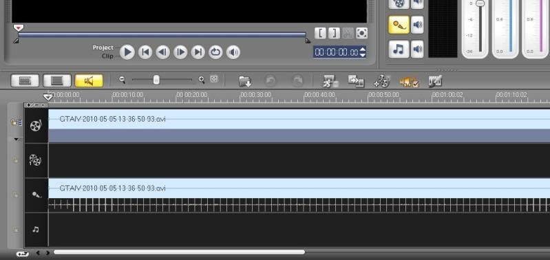

So! Here's what's going on. I have a 4GB video file, raw AVI format from FRAPS, drop it into VS, and if I hit play... it plays great! Perfect. I click on "Share" and it unselects the video from the Timeline and if I preview it here... it immediately starts this "popping" noise which pops basically once every second on the second (it happens right at the second transition... so 1.29 to 2.00, 2.29 to 3.00, etc). If I select the video in the Timeline it goes back to the "Edit" tab and I can play it fine here. If I unselect the video though (click on the empty Overlay line) and preview, it starts popping again. I've rendered a few different videos with the popping noise in it, and even used the "Split Audio" option... no popping if the audio is selected, popping if it's not. Removed the video, and created a WAV format file from just the audio, and it has the popping!
Closed out of VS X2, downloaded and installed the patch, still no help.
Last thing... the video file is fine, I can play it in any number of other video playing apps with no issues, it just seems to be VS X2 that has the problem.)
I did try searching the forum for this issue but most of the posts were years old. Any assistance would be greatly appreciated.
(Also, here's a pic of the popping audio "spikes". You can see that the first few are softer than the remainder, but this should illustrate it pretty well.)

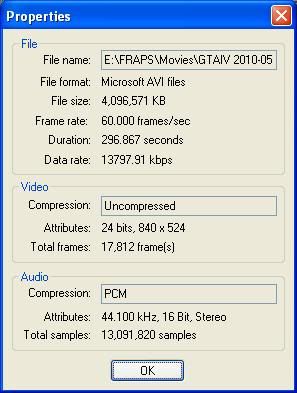

Can you right click on one of the avi files and select Properties, then tell us exactly what the audio format is, please.

Here's a screen shot of my video properties file.
If I do the "split audio" option first, the properties screen is the same.
