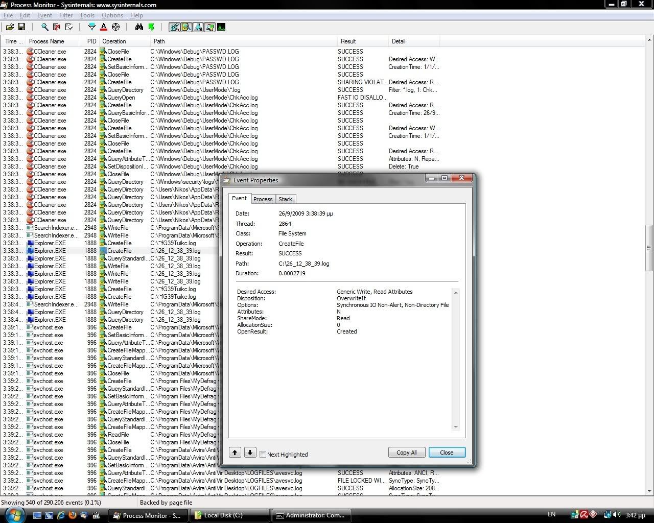

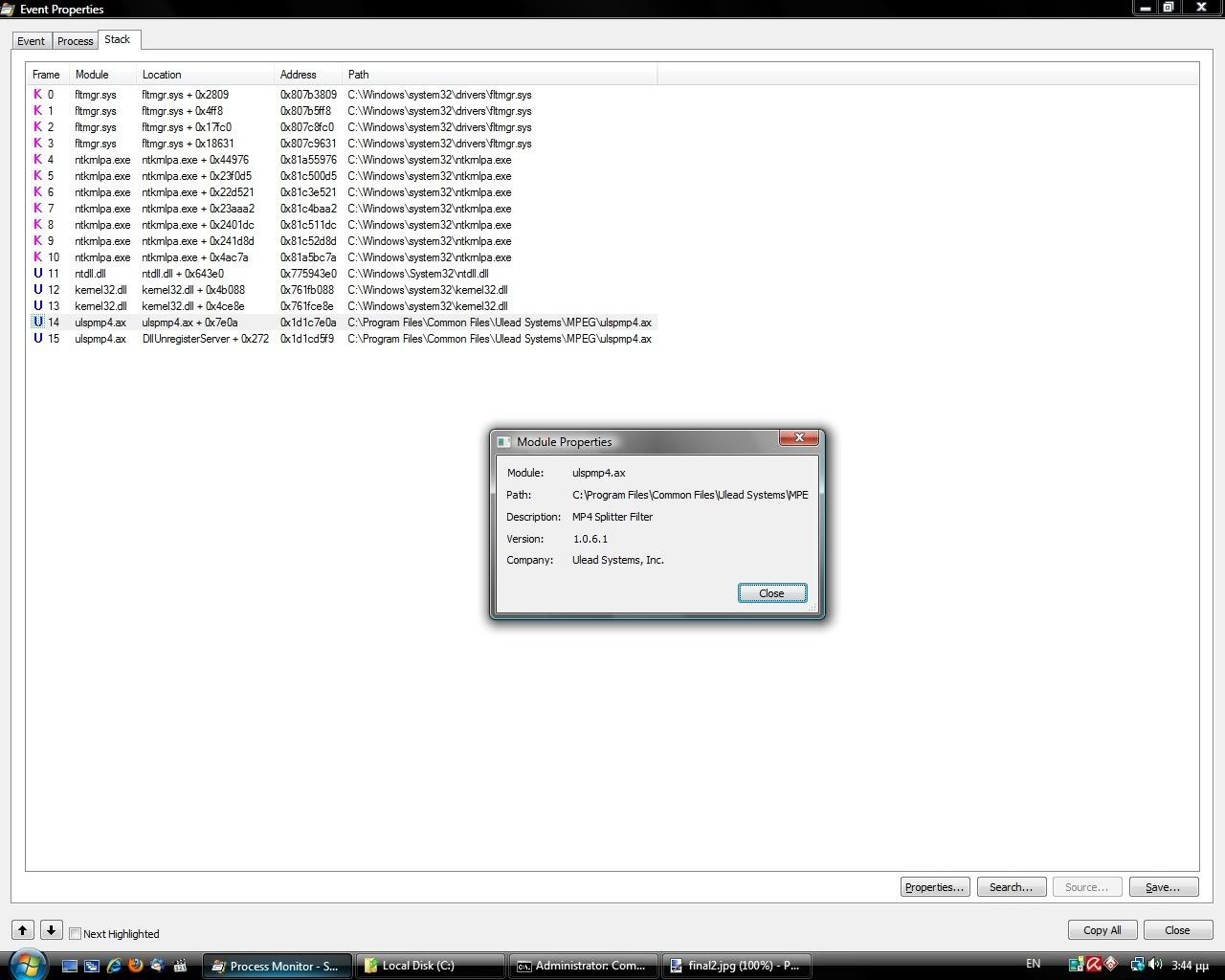

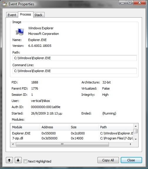

In the beginning I didn't know what was causing this. I googled it a bit but found nothing. Eventually, I decided to use Process Monitor from Sysinternal to see what is creating this. After a week of monitoring and 'playing' with Process Monitor, I finally found that this is caused by MP4 splitter by Ulead. I will give direct links from 3 images that I got from Process Monitor.
Image 1: The main screen that shows that Explorer.exe created the file.
Image 2: Details of the process
Image 3: The stack that shows where this came from. Here you can see that it is caused by ulspmp4.ax.
I checked and saw that this file seems to be updated from the patch since it has a date of 22/9/2008 as opposed to 9/6/2008 that most of the other files have.
