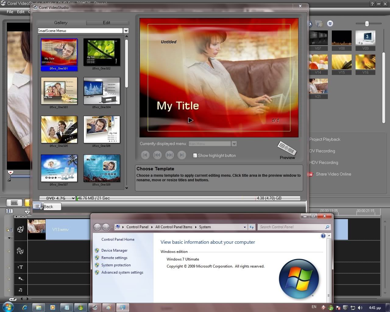

Another confirmation of this issue with VS12/X2 on Window 7. I'm using Ultimate 64 and get the problem with the missing icons in the burner window...
It also seems to be re-rendering the DVD file again despite my setting 'Do not convert compliant mpgs' on the ALt-J menu. Source files are all AVCHD. Paid upgrade from VS11.5 was downloaded 2 days ago.
The AVHCD transition problem remains visible.
Corel's reply to Heesenproductions implying that there is no problem is incorrect.

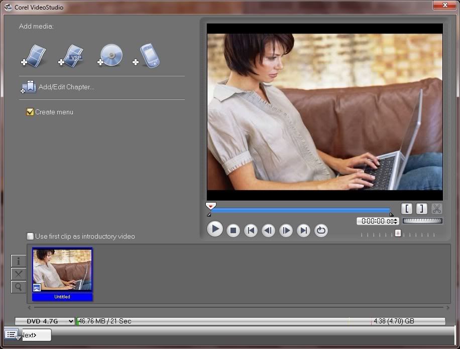

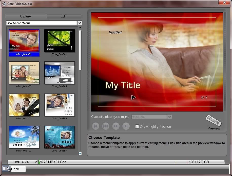

Here are some images if you want to point this topic to corel:
And a big one (full screen together with system info that shows the OS) that will mess forum so I give only the link:

Hi, I have not visit this forum for quite a while since I was using the softeware without any problem. Now I have Win 7 and also the same issue. The above screen shows that the button for video/audio adjusting is missing. You can not adjust bit rate or pcm or dolby digital any more. It means you can not change the data size on this screen.
jjyang
NO.sjj1805 wrote:There still isn't a problem!
Those are the buttons that let you go from menu page 1 to menu page two and back again.
He is looking, like the rest of us, for the NEXT button which should appear, to allow progression to the play and then burning screen. Alt-N works in these circumstances, just as on the burning screen, Alt-J will bring up the options, since they too are missing. But clearly a new user of the product, unless they use this forum, would not be able to get any further.
It appears that Ulead have never actually tested this product themselves with Win7. No wonder they still haven't fixed the AVCHD transitions issue.
