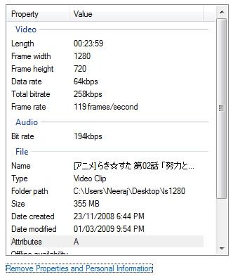

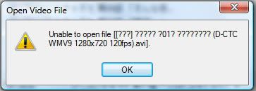

Describe your problem: When I try to open a certain video file in Ulead Video Studio 11, it gives me an error(shown below). I know the file is not corrupted because there are others I have like it that also will not open, however it opens any other .avi file fine. Windows movie maker also has no trouble opening this file.
Properties of your source files (format, file size, where did you get it?):
The file is a .avi
Project Properties (important):
I don't know how to answer this, all I do when I open videostudio is try to open this file and it won't open, so I can't even begin my project.

This is one of those strange WMV files wrapped in an AVI container, why this is done is beyond me. It should just be enclosed in it's own WMV...
Where did the source clip(s) come from? It may be that you need to convert it to some other format before inserting it into VS. Try running it through Windows Movie Maker, and saving it as just a WMV file, without that avi extension. You could also try using Super (google for it), to convert it.
By the frame sizes, this appears to a some form of High-Def video. Those are another difficult format to edit. Sorry I'm not versed enough on HD video to provide more help with them.

No the file is not "avi". AVI is just a container, a wrapper, that is commonly used for DV, Xvid, DivX, MOV, and even MPEG-4. Look at the second image you provided it states that it is a WMV9. Where ever the file came from used the Windows Media Video codec, but for some reason wrapped it in an AVI container. The main reason that WMM will accept it, is that it is a WMV file.
Where did the file come from, Internet download, DVR, camcorder? You might also check to see if you have Windows Media 9 Encoder series installed.

... And just as a minor experiment, make a copy of the file, then change its extension from .avi to.wmv and see if that will open -- as long as you have the Windows Media 9 Encoder installed as suggested above. :?:

The file was an internet download, I forgot where exactly I downloaded it from though. I do have Windows Media Encoder Series 9 installed. I tried changing the file name to .wmv but I still got the same error.
However when I used WMM to convert it to a WMV, VS was able to open it! I have a few other files that I can do the same with, the only downside is that it takes about an hour to convert them, but at least it works. Thank you! :)
