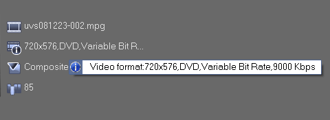

You can clearly see the dropped frames. Also, this image shows how many frames were dropped for almost 15" of video:
This is very disappointing. I really don't know if Corel/Ulead are aware of this issue. Do they think that everything is working fine? I have been loyal to VS series for some time now. And I am very disappointed at the moment. I can contact support and mention the problem but I don't expect 'miracles'. I have a video capture/editing/authoring suite and the first bit (capture) is totally useless. At the moment, I am capturing with other software, copying the files to VS and then editing. I may have a work around, but in any case, this is extremely disappointing.
