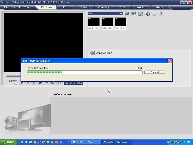

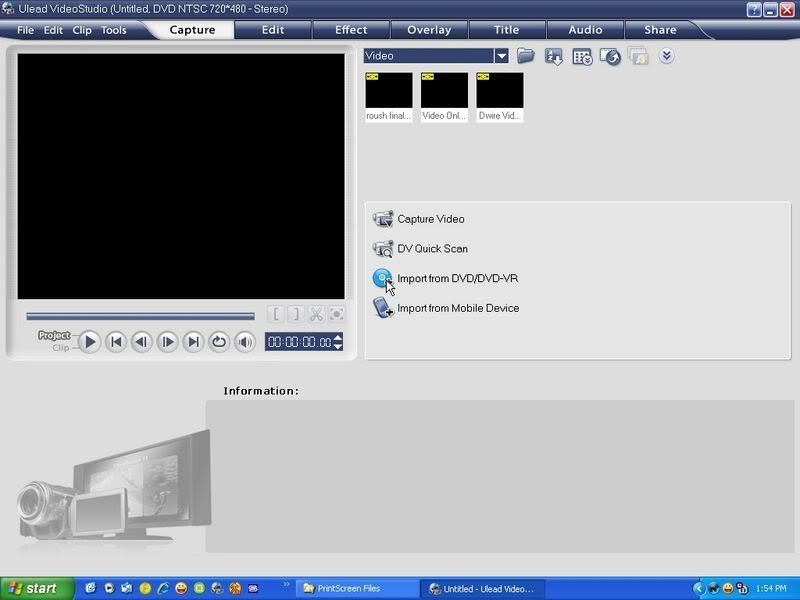

First I click here:
Then this:

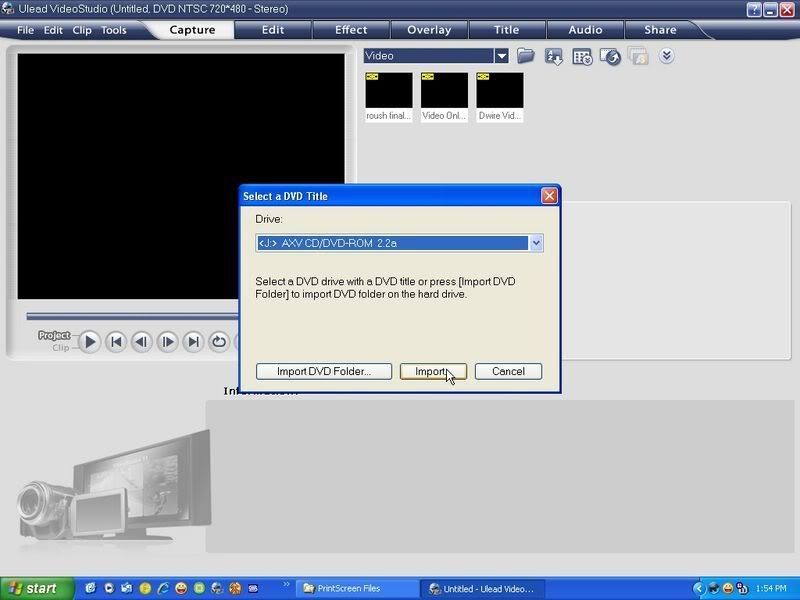

Then this happens as expected:

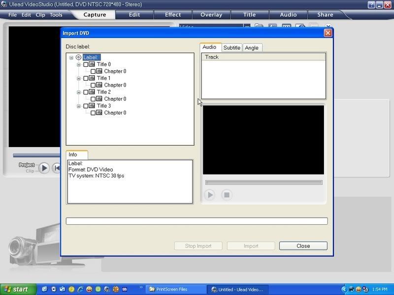

Which brings up this screen:

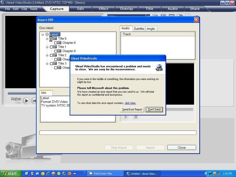

As soon as I click on any title as shown this happens:

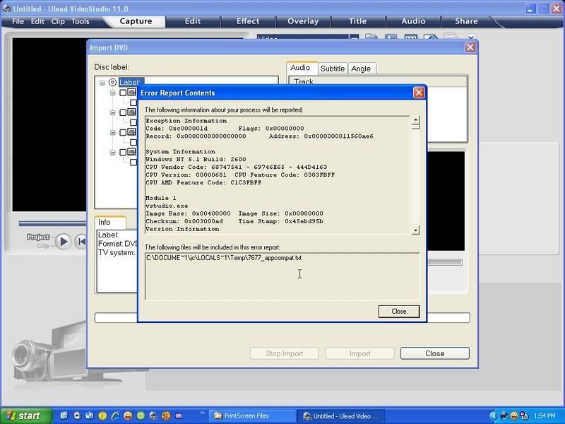

With this information:
And This:
Can anyone decypher what is going on here? Like I said it happens on both computers I have identically. I tried to capture using a third party program but the quality sucked. I want to re edit this clip off of DVD and post it on you tube now. Help please anyone!!
