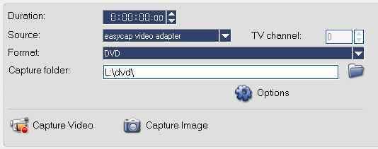

Open any video editor and go to the capture tab and make sure the EasyCap device is selected from the pull down menu as shown here,,,
Now that this has been done click on the options icon in videostudio SE and select the following below...

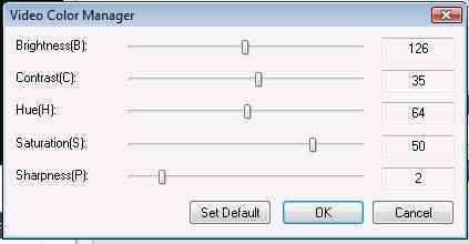

You can set your personal preferences to correct your video by going to the options icon and opening the video colour manager and "fiddle" with these settings below or go for default....

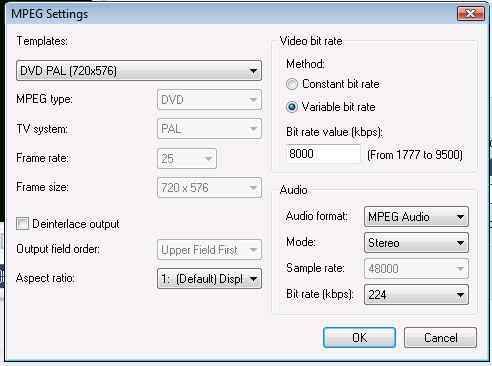

also in the options you might like to "fiddle" with the mpeg settings if you like as follows....
Note I use PAL settings for Australia but theres heaps of others under the pull down menu under the templates setting in the same panel.

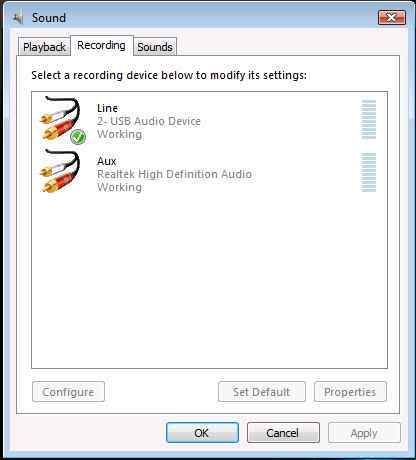

I checked my Sound/Recorcding tab and found that the USB device is already the default when it's plugged in?
