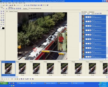

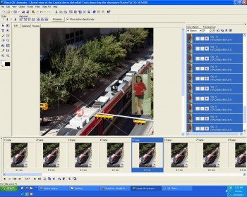

VikingAnimations,I tried the way you explained but something is not working.
My gif has 47 frames; a girl runnning.
I moved the 1:Frame to my desired position; a person chasing a train.
And all frames are the first frame (1:Frame) instead of a moving frames from 1: till 47:.

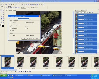

Synch the train, not the animation of the girl...

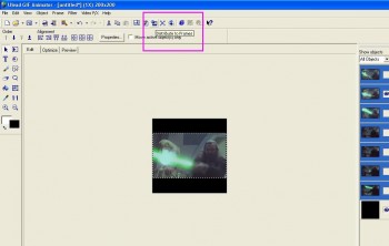

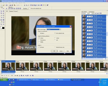

Open the animation you want in the background first.
Make sure frame 1 is selected.
Click the Add Image button Image
Select the animation you want on top of the first one, and make sure the options are checked as selected on the attached image below. (insert in the current frame, and distribute to individual frames should be selected.)
Select frame 1 again.
Select the Pick tool, make sure "move active object(s) only" is NOT checked. Position the second animation where you'd like it.
Use the Synchronize button: Image
Use these settings: Image
You're done.
