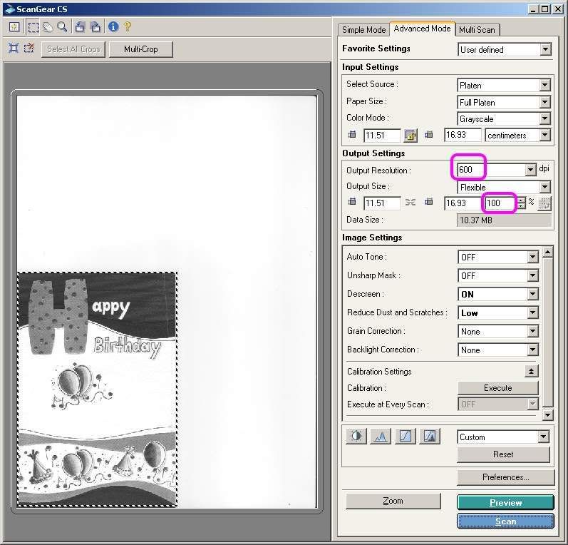

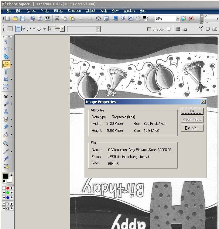

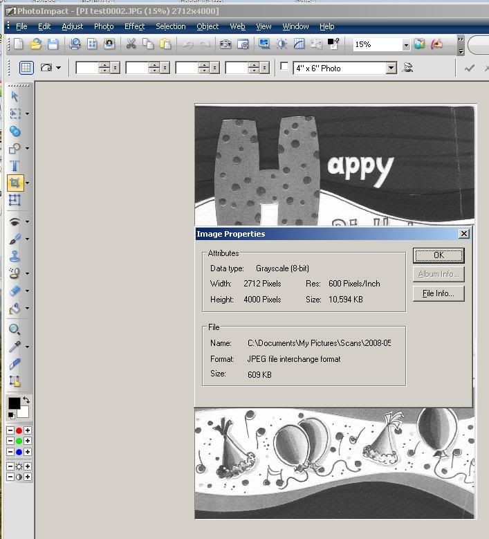

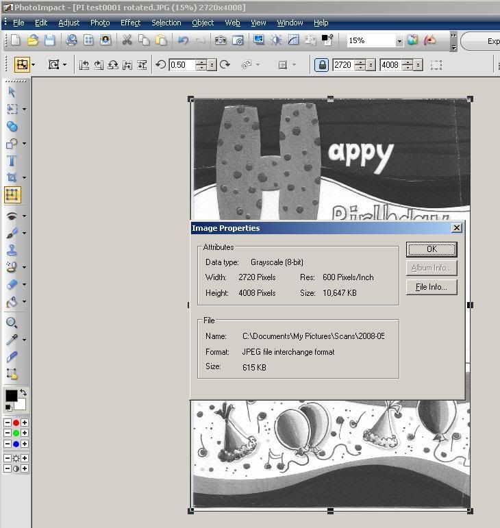

Well, I just did a test as well in PI X3.
I scanned a small page with 600 ppi and saved it. Rotated it physically (in the scanner) and scanned it again with exactly the same sttings.
Both images opened in PI show a resolution of 600 ppi. After rotation of the one page and saving it again, PI still reports the resolution as 600 ppi.
I still don't understand what all the fuss is about because this reading has no bearing on the image at all. The pixel size is still the same and that is the only measurement that counts.
Just click on the thumb nail to show a larger image.
