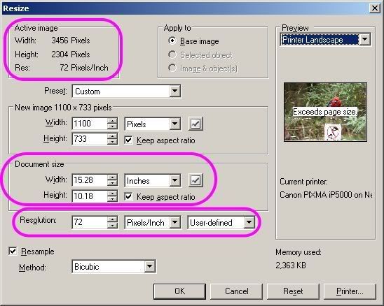

Open your image in PI, go to the "Resize" menu, you will see something like this, just click on the image below to see a larger view of it:
The dialog box shows your active image size in pixels, the new image size after resampling, your document size (print size) and the resolution.

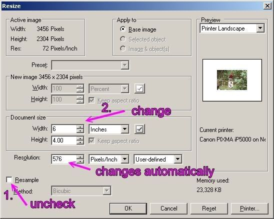

Now, untick the resampling and set your document size to 6" wide (make sure keep aspect ratio is selected or your image will distort)
What you will see is something like this:
The resolution has changed automatically in order to allow your image to be printed in the requested size. No resampling has taken place (it's greyed out) and your image has not deteriorated. It is still the same pixel size as it was before.
What you are doing with your process is to reduce the pixel count of your image which discards the information held in these pixels. The resolution is very low and, in order to actually now print this image at a decent print resolution, PI has to reinvent missing pixels.
You can also just skip this step altogether and try to print your image from within PI by clicking on the Print Preview icon. If you did not change the size of your image beforehand, PI will tell you that your image is to large to be printed on that page and asks you to increase the resolution to reduce the physical size of your image.
In a nut shell: Never resize your image for printing. Increase its resolution only, with resampling unchecked, to reduce the physical print size, not the image.
