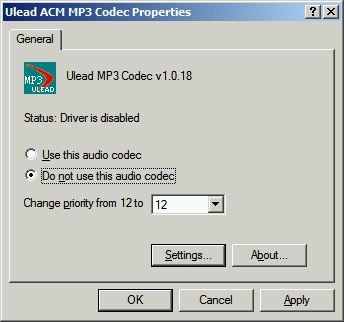

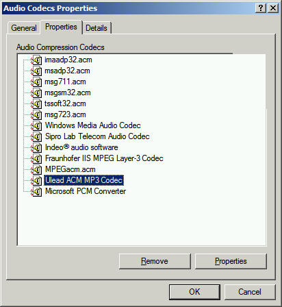

with regard to my audio problem when trying to edit .mov files from Panasonic digicams, I decided to check the audio codecs on my pc.
When I checked the properties of the Ulead ACM MP3 codec I was surprised to see that it was disabled. It was the only codec of all those listed that was disabled.
When I checked the "Use this audio codec" button, it seems to have solved the problem. I can now successfully edit the .mov files.
Hopefully it won't have any adverse effects on other programs.
Might be worth checking the audio codec settings on your problem pc's.

In regards to splitting up the audio from the movie. Made no difference. What did make a difference is to convert the *.mov to mpg file types and use these on the timeline (instead) however I have noticed that the quality has been affected (video - jagged) - audio (fine) - & when I try to share out to disc - ULEAD VideoStudio 11+ crashes. To get around this - I had to - Share out to a file - and then use Nero to create the DVD. However I want it all to be in the one programme to recognise the chapters etc.
2 Dogs - In regards to the codec - as you have detailed below - the same has occured on my machine - I enabled it - as you have specified - re-booted my machine - it made little difference - when they were placed on the timeline and played. Like I said - they play ok - when they are in the library and previewed - but not on the timeline. Thanks for your help..!!!
