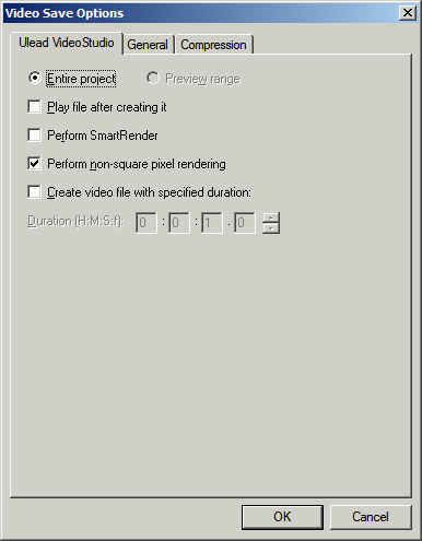

To create the .mpg file with all the right settings, you will need to use "Share > Create Video File" and hit the "Custom" option in the drop down box. You can see the video and audio properties in the image below.

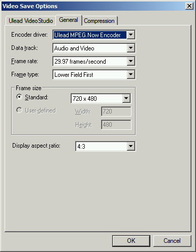

To get to set or change the properties, click on the "Options" button. This brings up the "Video Save Options" box. I generally prefer to uncheck "play file after creating it" and in this case, since you will be re-encoding the source files, I also uncheck "Perform SmartRender"
Hit the "General" tab. These would be the settings for NTSC video captured from a digital source, eg a MiniDV camcorder. For analogue video sources, you'd set the "frame type" to "upper field first". If you intended to play the finished DVD only on a pc, you might even choose "frame based".

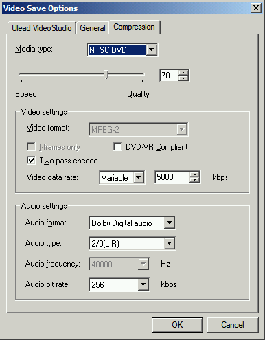

Now to set the video bitrates and other settings, click on the "compression" tab, which will bring up the following box:
First of all, you'll see that it's set for NTSC-DVD. (In PAL lands, you'd obviously select PAL-DVD.) Below that is a mysterious slider, with "Speed" at one end and "Quality" at the other. The default setting is 70%, and I generally leave it at that, though sometimes push it up to 100%.
More significantly, perhaps, you'll notice that I checked the "Two-pass encode" box. That would be my personal preference in order to squeeze the best possible quality out of the resulting video - but it comes at the expense of roughly doubling the encoding time.

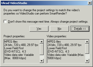

Now assuming you've created a single mpeg-2 file of less than 4.7GB (in fact usually less than 4.35GB to give a bit of a margin on the disc) you should open a new, blank VS project file. In order to set the project properties, insert your previously created mpeg-2 file into the timeline. This should bring up the following box - I've clicked on the "Details" button:
Unfortunately the image doesn't show all of the video and audio properties - you can't resize the box, but have to scroll down instead. In any case, you can see that the VS defaults were for 8000 kbps variable bitrate, Dolby 5.1 at 384 kbps, and that the box prompts you to click on the "Yes" button to change them to match the properties of your mpeg-2 file, which is what you want.
Now here's the counter-intuitive bit. Having set the project properties, you delete the file from the timeline! I don't think I would ever have guessed that step, and it's not something that was ever in the manual! Then go to "Share > Create Disc" which brings up this box:

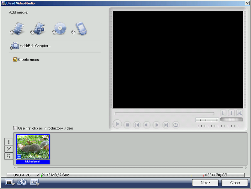

Under "Add media:" click on the left filmstrip icon and add your single large mpeg-2 file. If you then click on the "cogwheel" icon at the bottom left, you can bring up the following box, which should confirm that your project properties now match your mpeg-2 file:
Note that this time, the "Do not convert compliant MPEG files" box is checked - this will cause VS to SmartRender your project, which is what you want.
