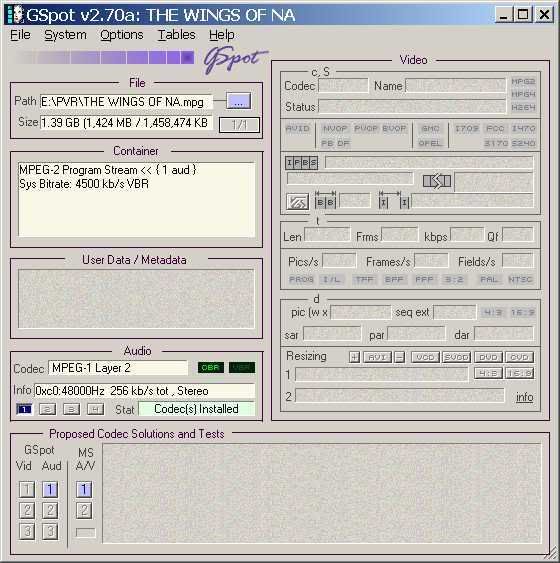

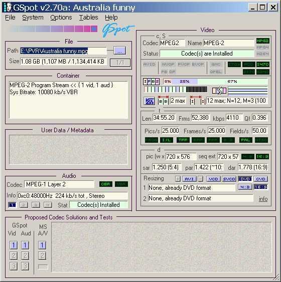

Just noticed something funny. As I said already, the half hour documentary came out just fine. The 1 hour show, split into 3 segments when downloading to the PC, has very distinct OOS issues.
Both programs, as far as I can tell now, where downloaded using the same procedure and connection.
Looking at the converted mpeg files, G-spot has this to say:
Something is fishy because of the differences in file properties.
Any ideas anyone?
I'll burn the show to DVD now without any editing. I'll let you know.
Any ideas anyone?
