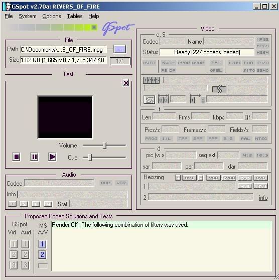

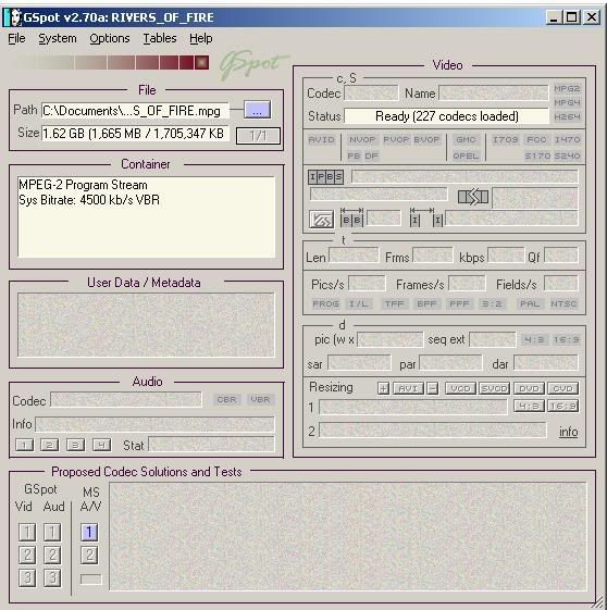

Ok, that's just revealling nothing isn't it? All it seems to be doing is reading the header and saying "This is an MPEG." Just nothing else showing up.
I wish I could help you on this one but I have no idea and no eperience with this sort of action. Hopefully some of the other more knowledgeable guys will come on as the day/night wears on.
I just noticed on the download site for thsoe codecs there are two versions, I am assuming you didn't use the Beta and used the stable one.

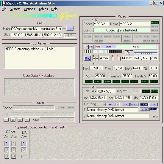

It may be using funny PIDs or contain the necessary information later in the file.
VRD has some additional specialty settings that may be able to resolve it for you.
