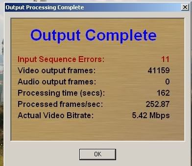

I tried to run the mpeg file through VideoReDo but that encountered the same problem as well :twisted:
I uninstalled the codec pack and restored my system to an earlier restore point. No more problem. Still no sound on my file though.
When running this mpeg file through VideoReDo I got this error message
but the file plays in MediaPlayer, of course there is no sound.
Still have a lot of testing to do here :roll:

What problem did you encounter with VideoReDo? Please see above
Did it play OK? Was it silent also? Yes
There is an issue with no audio frames output. Try clicking on the menu: Tools>Select Stream to select a different audio stream.
If you don't don't see any audio tracks, Click on the menu: Tools>Options>Stream Parameters and check "Ignore Transport Stream Maps"
What are the file properties in VideoReDo? Load the file and press Ctrl+L and paste the info. There's a button near the bottom of the window "Copy to Clipboard" Shall do
Also, you should post over on the VRD forum. They'll get you working OK.
http://www.videoredo.net/msgBoard/index.php
At this point in time I do not blame VRD for my woes :wink: just posted here to give others the benefit of my experiences.
