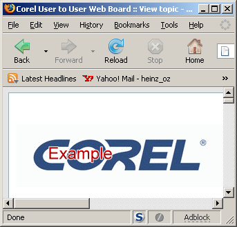

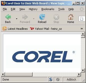

@cinmcw
Let me try to explain it with the help of some images. Click on the thumb nails to get a larger image.
I took a screen print of our forum header and cropped it in PI
Then I created a new image with a transparent background in PI. The image below shows both images open in PI (screen shot). Note the transparent background in the one with the word "Example"
When I click on the word "Example" in PI and drag the word over to the background image, Ctrl+c and Ctrl+v on the background is the same, I will get this.
However, when I only look at the saved png of the image with the word "Example" in an image viewer program, it will look like this
Placing the image code of the png image image here in my post, the transparency shows again because the png image is placed on this, our forum background.
